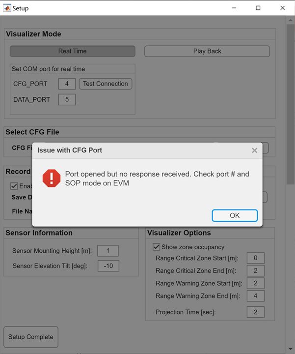

I am using SDK 03_05_00_04 and Industrial toolbox 4_7_0

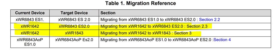

I followed the steps of Migrating to xWR68xx and xWR18xx Millimeter Wave Sensors
I applied the steps in section 2.3 and section 3 because there is section explain migrating from xwr68xx to xwr18xx directly:
I flashed area_scanner_68xx_demo_isk.bin into AWR1843 target
then when I run the demo and press Test Connection it gives this error.
Also when I press setup complete it gives me this error
Opening as_demo_uart_stream.txt. Ready to log data.
File \\ not found!
Error: Could not open CFG file. Quitting.>>

    "C:/ti/mmwave_industrial_toolbox_4_7_0/labs/area_scanner/68xx_area_scanner/src/mss/mmw_mss_linker.cmd", line 12: error #10099-D: program will not fit into available memory.  run placement with alignment fails for section ".l3ram" size 0xbff00 .  Available memory ranges:
       L3_RAM       size: 0xa0000      unused: 0xa0000      max hole: 0xa0000
    error #10010: errors encountered during linking; "area_scanner_68xx_mss_isk.xer4f" not built
    >> Compilation failure
    makefile:183: recipe for target 'area_scanner_68xx_mss_isk.xer4f' failed
    gmake[1]: *** [area_scanner_68xx_mss_isk.xer4f] Error 1
    makefile:176: recipe for target 'all' failed
    gmake: *** [all] Error 2
    **** Build Finished ****
    As a heads up, it seems that you are using the 18xx device which is in the 77GHz band (primarily used for automotive exterior radar) for an application that may be better suited to the 60GHz devices (such as 68xx).
    In terms of the errors, is there an extra .cmd file in your project? The lines that say that the memory ranges are already defined would likely indicate that they are defined in another file elsewhere.
    Alec
  • Mostafa,
    Since this project uses the "link" instead of "copy" style of importing, most of the files in your workspace are symlinked to wherever you import them from, meaning that I do not see the majority of your project files in that zipped folder.
    Alec
