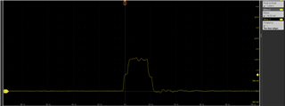

AWR2243: awr2243 Cascade, 1 Master 5 Slaves, Master chirps, Slaves do not
Part Number: AWR2243
We have built a custom casdcaded radar board with 6 chips, 1 master 5 slaves, we can see the master chip transmitting/ radiating chips, but none of the slave devices are transmitting. I have confirmed the set up from software is correct setting the rfChanCfgArgs {1, 2, 2, 2, 2, 2} for each device map. We have measured the 20 GHz LO clock is present going to the slave devices. Number of TX antennas is set to 3, as the internal LDO is configured correctly as well. Is there another thing to check for in this regard?
