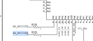

I am using the IWR1443BOOST EVM in standalone and have flashed it with the OOB demo modified to have hardcoded config (from https://e2e.ti.com/support/sensors-group/sensors/f/sensors-forum/846384/awr1843boost-hardcoding-config-onto-the-device) such that UART data is streamed automatically upon powering the EVM.
My question is, how can I reroute the UART from the USB port to somewhere else like the BP/LP header? I can see in the schematics that there are many connections to AR_RS232TX/RX on the board, but none of those points show any data when probed.
Any help is much appreciated.

  • Hello Nicolaj,
    Please refer to the schematics to get the UART/RS232 routing options. You need to disconnect the resisters R128 and R129 going to the TM4C chipset (for USB connection) and mount the resisters depending on the path you need. For example mount R169 and R166
    Vivek
  • Hello Vivek,
    Thanks for your reply.
    So copying or re-routing the UART signal to another pin purely programmatically is not possible?
    Nicolaj
  • Hello Nicolaj,
    That is correct.
    Vivek
