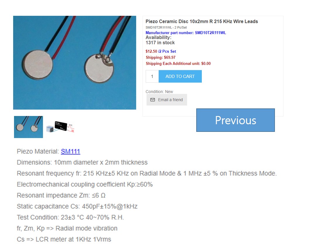

Previous (10 mm):
(Website link: https://www.steminc.com/PZT/en/piezo-ceramic-disc-10x2mm-r-215-khz-wire-leads-smd10t2r111wl)

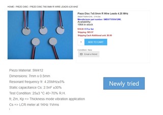

Current:
(Website link: https://www.steminc.com/PZT/en/disc-7x05mm-r-wire-leads-4-mhz)

    Upon reviewing the information submitted for both the Steminc SMD10T2R111WL 10mm transducer and the Steminc SMD07T05R412WL 7mm transducer: the reason why you are not getting a correct result is because the transducers resonant frequency of the 7mm transducer is 4.25MHz when your previous transducer had a resonant frequency of 1MHz.
    There are two things to pay notice on why the transducer is not working, the first one being that the TDC1000 spec limit for operating frequency is 4MHz, so the 7mm will not work with this device since it is out of the operating range with a 4.25MHz signal needed to drive this transducer.
    The second reason is the setup it does not apply for this situation since the frequency is out of range. But in case you are interested in using another frequency transducer with the device you must update the TX_FREQ_DIV setting, this takes the internal 8MHz clock on the TDC1000-TDC7200EVM and divides by 8 (your current setting) in order to producer the 1MHz signal needed to drive your 10mm transducer. In other words you have to ensure that your internal clock is being divided to match the transducers resonant frequency. If you cannot divide 8MHz to get your desired frequency, you may always use an external clock and divide that accordingly. The clock frequency can be anywhere between 1-16MHz if using the GUI.

    3. Finally, 10 mm in the previous question has the frequency of 0.215 MHz, not 1 MHz.
    Not wired type (SMD10T2R111) has 1 MHz but I am using wired type. You can check again as in the image.
    Do you think it is typo of STEMINC so you think 1 MHz is right?

    3) My mistake on this one the transducer mentioned is a 215kHz transducer and not a typo on Stemincs behalf.

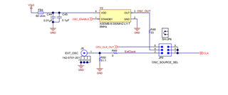

    1. Regarding your answer 1), I want to check whether what I understand is correct.
    It seems that J8 is connected to 2nd pin of JP6 inside the module circuit.
    Therefore, I just need to buy and connect "clamp type plug" (for example, https://kr.mouser.com/datasheet/2/643/pi-CCS-JOHN-142-0207-016-1290205.pdf) to connect with the external oscilloscope? Or can I also connect (+) of the oscilloscope to J8 and connect (-) of the oscilloscope with (-) of module together? Could you please tell me what connector I need to buy? (Link for the specific product or terminology will be appreciated).

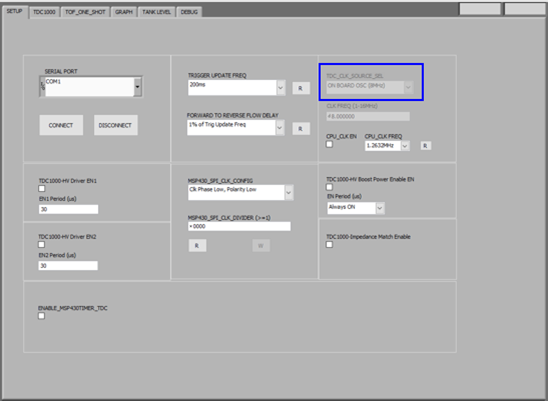

    3. With the external clock, how can I change the blue-marked in the below GUI?

    1) Yes, J8 is connected directly to pin 2 of the JP6 jumper. But just to be clear J8 is not used to connect to an oscilloscope. It is used to connect to an external clock source or a function generator in order to generate the clock needed by the devices. You may be able to use the CPU clock as well for this, moving the shunt on JP6 to position 5 and 6 and updating the GUI to use the CPU clock at 1.7143MHz (1.7143MHz/8 = 214.29kHz) this should be close enough to get the proper performance.
    If you would like to use the external clock though you would need an SMA Female connector if it is not populated for J8 and then depending on your external clock you will mostly likely need an SMA to BNC connector, but keep in mind this depends on your equipment, I am not familiar with what connectors will be on the devices you are using.
    2) The clock signal used is typically ~3.3V square wave, if you need more info on the clock signal you can take a look at the datasheet here or probe the internal clock (pin 4 of JP6) this should give you the info you are looking for.
    3) In order to make the changes you need to have the EVM connected. If the EVM is not connected it will look greyed out like it does in your image. With a device connected, to use external clock or CPU clock, click on the TDC_CLK_SOURCE_SEL dropdown and select EXT_CLK or CPU (make sure to also change the shunt on JP6 to the position you selected on the GUI).
    For External Clock- Type the frequency you are using on CLK FREQ box source must be from 1MHz-16MHz.
    For CPU Clock- Check the CPU_CLK EN box and choose the frequency would like to use in the CPU_CLK FREQ dropdown.

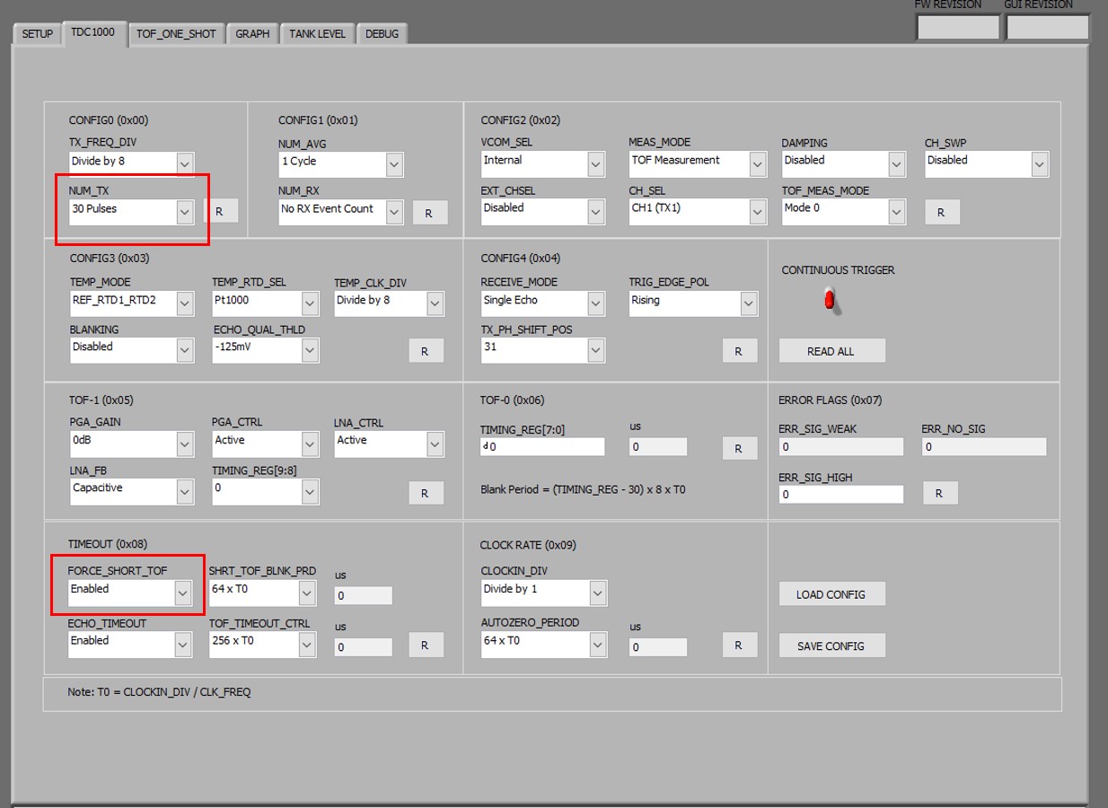

    3. Finally, I am considering change in Num_Tx and Force_short_TOF as in the below.
    Can change in Num_TX and Force_short_TOF bring about different TOF value?
    If so, is there any suggestion for my setup or different recommended Num_TX / Force_short_TOF for certain level of water?
    Minrak Kim

    3) Changing NUM_TX will increase the amount of pulses you are transmitting to 30, but the more pulses you transmit you sacrifice the minimum measurement you can obtain, so you have to find a good balance between SNR and minimum distance needed. FORCE_SHORT_TOF is a different mode used to obtain short ToF measurements, what this does is give you the ability to trigger your echo listening window earlier than you get in the standard ToF measurement mode. Use of this mode mainly depends on what are your expected water levels so it is difficult to make suggestions without more application specifications.
    This FAQ should help you with many questions about the setup: e2e.ti.com/.../faq-tdc1000-everything-you-need-to-know-for-ultrasonic-tof-liquid-coupled-collateral-tools-designs-faq
