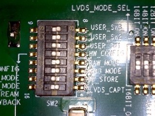

  • Hi Drew,
    thanks - I'll go through all that tomorrow.  My DCA1000 is just set exactly as it arrived - haven't yet got as deep in as all its switches, and the IWR SOP switches are set as I believe the DCA  video says (this seems to be different for the Visualizer s/w) as 011 which should be debug mode.
    best regards
    Alan
  • Hi Drew,
    looking at the DCA switches, SW2.5 is set to "CONFIG_VIA_SW" , so presumably the rest of the switches have no effect, and everything is controlled by mmWave Studio?  Do you think this is purely a DCA issue i.e. the IWR is probably working now?  What else could I check to determine what is/isn't working - not lease so I can give you good info to be able to diagnose things.
    thanks
    Alan

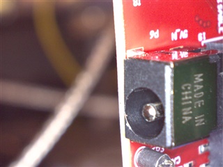

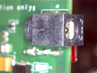

    The DCX & IWR modules have different types of 5V power connector.  The DCA on seems fine.  However, the
    IWR one is pretty bad: you have to be very careful with it to get the IWR to power correctly, and
    not touch it once things are going.  I'm judging "correctly powered" by getting the yellow led on & the
    red warm start one off.  I just wonder if - when it gets to RF power up activities, the power drain
    in creases, and (because the connector is poor) perhaps the 5V supply on-board is dipping ... enough to
    drop the USB momentarily, thus upsetting the mmWave s/w.  Can't see anything like this happening in

    Your issues with the power connector are a bit concerning to me, have you tried a different cable? I would not say that what you are seeing is typical behavior. Going back to the out of box demo issue, given that the sensorStart command was sent and the device did not start, I would imagine there is an error cropping up somewhere during the sensorStart process. Some questions and recommendations below:

    The PSU connector certainly isn't good!  I have two (IWR & DCA) - which I can swap, and the problem stays on the IWR, the DCA always being happy, so it doesn't seem to be the power leads.
    On this, I seem to get two states: green power + yellow DS4 I think, which would be AR_NRST; or no yellow, green PWR and a RED on I think warm reset.  I always make sure I've got GREEN, YELLOW & no RED before I do anything else.
    I still worry that, when we get to device activation, it takes more power, which the connector can't supply, so the whole thing hangs.  Difficult to actually prove, though.
    Another busy day ahead - I'll try to get to re-doing the flash a bit later.  I think I'll also have a good look at the schematics - I wonder if I can supply 5V by some other means e.g. the 20W 0.1" connectors on the back.  I don't want to start soldering anything just yet - very little chance of being able to return the board for a replacement (just in case) if it looks like I've been modifying it!
    thanks
    Alan

    managed to look a bit deeper: there doesn't seem to be a convenient or safe place to monitor voltages on the IWR, so I've looked on SW3 on the DCA - not really correct method (IWR 5V comes down the 60way HD connector), but its a start.  I've also done a very quick GUI which reads the config file & sends it ... a bit easier than typing in PUTTY.  I've also made it so that it doesn't send the final command, I start the sensorStart by hand, so I can control timing.  When sensorStart is sent, there is a definite drop in the 5V supply voltage.
    As a further experiment, I disconnected the DCA. Now, I get a response to sensorStart - and, the aux port is suddenly alive (in putty).  The visualiser now seems to work too: can't believe it would get that far unless pretty much everything else was working.  It appears that the DCA adds some loading to the IWR? (DAC has its own supply & SW3 set to DC_JACK_5V_IN)
    However, I still have a questionable power connector, and I need the DCA so I can see the ADC data for my research.  It looks like I could wire across SW3 on the DCA, which should link the two power connectors together, and thereby power the whole thing via the DCA ... not a normal configuration. However, first I'd like some confirmation that this would be a safe thing to do - and that you agreed to this mod.  I reckon we have good indication that its all working OK, bar a duff connector, but just in case anything has to be returned! I've attached photos of the two connector designs, just so you know exactly what I have.

    What firmware are you using in mmWave Studio? It says there is a firmware mismatch in the log. You should be using the latest firmware from DFP 1.2.6.3 located at C:\ti\mmwave_dfp_01_02_06_03\rf_eval\rf_eval_firmware directory (assuming you're usingthe default install path).
    Also, you should set the switch SW2 to AWR1642_MODE for AWR1843.

    I'l leave this thread open a little longer to see if anyone can confirm whether the DCA SW3 link & using the DCA power connector is OK to do.
    As for firmware & DFP things - I'll have to check and get back to you on that.

    Next, I've gone for it an linked across DCA SW3, so that the two psu inputs are connected together - so I can now power the whole thing reliably using the DCA input - this is of course how I then found out the the OOBdemo doesn't work if you've got a DCA attached.  OK, the video for the demo doesn't show a DCA, so maybe fair enough!
    Back to mmWave Studio - it all connects and seems to set up, but still no data.  Having just remembered the OUTPUT tab, it gets to RFINIT and says:

    As for DCA switches, it says somewhere that SW2:5 should be set to configure_via_sw - does this override the other switch positions, especially SW2:3 for the LVDS mode? I think I sent you pictures of the DAC switches previously.

    For the DCA1000 switch setting, please use the setting highlighted in the figure below.

    Now, going back over something from before: I had another look at the 5V supply, wondering if what its saying is that once things really get going, it takes more current ... and I definitely see the supply dip quite substantially at RF INIT.  Now, I already know that the power connector supplied on my IWR is terrible, you have to waggle it to work & then don't breathe.  However, maybe that's not the only problem here - so I looked more closely at the bench supply I'm using. Despite saying it should be up to the job, I've tried another one to be sure.
    No supply dip on the boards ... no time out and, eventually, I've got data captured and all the way through to the matlab screen!  I think we'll have to call that one-all for 5V issues - one dubious connector, and one dodgy bench unit!  Now, the real work starts...
