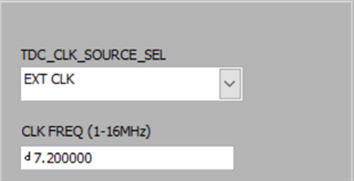

For TDC_CLK_SOURCE_SEL, I selected the external clock and put CLK_FREQ as same as waveform generator (6 MHz).
And for TX_FREQ_DIV, I selected "Divide by 2" so that I can match the frequency of transducer (6 MHz / 2 -> 3 MHz).

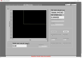

However, when I click  "START GRAPH", the GUI is stuck and doesn't show any data.
I had to shut down the program.

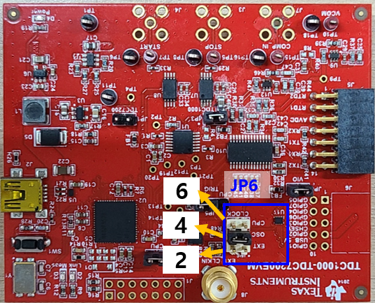

    Thank you for your question and the detailed setup. It sounds like the EVM is properly configured for 3MHz operation, I just want to verify everything matches on my end. Does your EVM have JP6 populated as the picture below illustrates? Additionally, is this 6MHz clock signal being driven through the J8 SMA connection?

  • And I have one more question about shunting of JP6.
    In the "TDC1000-TDC7200EVM User’s Guide" (as in left side of figure), "EXT_OSC" is done by shunting 2 and 1 in OSC_SOURCE_SEL.
    But what is written on the board is in the opposite order (From the top, it says top is ext, middle is OSC and bottom is CPU).
    To match with "TDC1000-TDC7200EVM User’s Guide", do I need to put the module upside down as in below?
    Please tell me which one is correct and I sincerely appreciate your past replies with picture illustration.
    BR,
    Minrak Kim.
  • Hi Minrak,
    Sorry for any confusion between the schematic and the User’s Guide instructions.
    For driving an external clock, populate a jumper in the JP6 row titled “EXT” (pins 1-2 on the EVM).
    You are correct in the orientation of the pins for the OSC_SOURCE_SEL. The EVM has the pins oriented upside down compared the EVM schematic.
    In this image, you have labeled the pin numbers correct. Another way to tell the numbering of pins is via the pin 1 indicator included in the top overlay of the EVM. I have highlighted the pin 1 indicator on the EVM picture with a yellow box. This pin 1 indicator will match with pin 1 of the schematic. Note, the jumper in this picture will need to be moved to pins 1-2 in order to externally drive a CLK.

    Those are the primary settings I first use to setup an external clock.
    I am also surprised to hear the 8MHz internal OSC is giving a proper TOF measurement with a 450kHz transducer. For an 8MHz clk, the closest transmit frequency achievable is 500kHz with a divide by 16 in TX_FREQ_DIV.
    What is your external clock frequency, and what is your TX_FREQ_DIV setting?
    These are possible settings below that would could be suitable for a 450kHz transducer with an external clock.
    As another method for debugging, you could drive the external clock with 8MHz and see if the TOF measurements match the results using the oscillator.

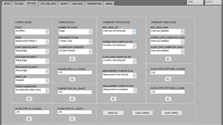

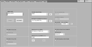

    So let me summarize the results one more time. This time, lets discuss about "CPU" clock first.
    In summary, chaning JP6 stucks GUI and I have to turn off the software.
    I used SMD10T2R111WL (10mm, 215 kHz). For this, settings for "setup", "TDC 1000", "TDC 7200" and "Tof-one=shot" are as follows.

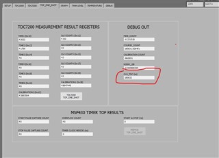

    You can see that Tof-one=shot does not give any results as indicated by "NaN" (red mark). So "drive the external clock with 8MHz and see if the TOF measurements match the results using the oscillator" doesn't work for me as it just stucks.
    <SETUP>
    <TDC 1000>
    <TDC 7200>
    <TOF-one-shot, JP6-"CPU">
    I said JP6 makes a problem because, when I do the same thing with JP6 on "OSC", it at leasts give me TOF value.
    All other settings are the same.

  • Hello Minrak,
    Thanks for the pictures of your setup, and the error you are receiving. The GUI will seem to freeze because there is likely no transmit frequency (caused by the TDC1000 not receiving a clock) when you click "TOF_ONE_SHOT".
    That is correct, the module will not use the CPU clock for the TDC1000 unless JP6 is set to CPU. Given your settings, the only way to receive "NaN" in CH1_Field is to select a CPU clock in the GUI, but set JP6 to "EXT". JP6 has the control of selecting which clock signal is used by the TDC1000, the GUI only configures the CPU clock and alters the GUI settings to reflect the utilized transmit freq. This is why the TOF measurement works when you move the jumper to "OSC", but not when you set JP6 to "EXT". The only way you could receive the "NaN" message in CH1_Field with JP6 set to "CPU" would be due to a damaged microcontroller. You could test this through probing JP6 with an oscilloscope. Another great method for debugging is to probe the transducer output with a scope probe for initial testing. Note, in some cases the probe can negatively affect the transmit and receive characteristics of the transducer due to the impedance of the probe.
    Additionally, I do not think the current EVM settings will be optimal with a 215kHz transducer. I was able to replicate your settings with a similar transducer, and I was unable to receive a measurable return echo. I am including a document in this thread that will be very useful in reconfiguring the EVM settings for use with a 215kHz transducer (Link Here). See "TDC1000 220kHz Configuration" for a similar configuration to what you can use with your EVM.
    To use the 215kHz transducer, you will need to alter the GUI settings as suggested by the optimization application report, and change the external filters used by the TDC1000. The TDC1000 datasheet details the calculations for specific filter frequencies in section 8.3.5. (Datasheet Link Here).
