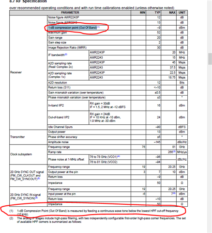

Hello teams:
As describe in AWR 2243 datasheet, 1-dB compression point why is marked as "Out Of Band".
Hello teams:
Hello Bryan,
There are two kinds of 1dB compression points, namely in-band and out of band.
The out of band p1db is specified in the RF Spec table whereas the in-band P1dB is specified as a plot in Figure 8-1.
The below two threads also highlights the difference between the two :
(13) AWR1642: About P1dB value - Sensors forum - Sensors - TI E2E support forums
(13) AWR1642: P1dB - Sensors forum - Sensors - TI E2E support forums
