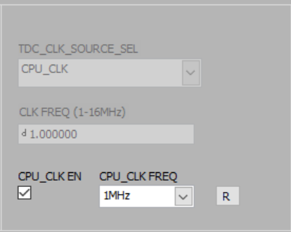

Regarding the last answer by "Jacob Nogaj", he mentioned "the module will not use the CPU clock for the TDC1000 unless JP6 is set to CPU. Given your settings, the only way to receive "NaN" in CH1_Field is to select a CPU clock in the GUI, but set JP6 to "EXT".
However, I did select CPU clock in GUI and set JP6 to "CPU". Whenever I set "JP6" to "CPU" or "EXT" to match GUI settings, it just stucks. GUI doesn't move and I need to shut down the program by force.
I followed everything correct as you see in the previous posts.
Please help me so that I can use CPU or EXT clocks for transducers I am using.

    First, I am going to test the CPU clk option. I configure my board to look as the picture below displays (JP6 connects to CPU CLK):
    Then configure the GUI to include the CPU clock:

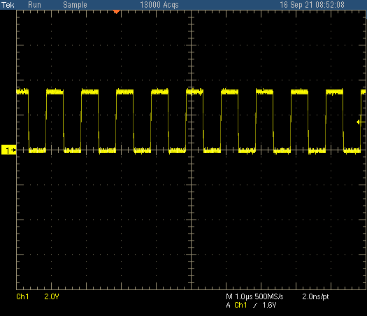

    Then Probe the testpoint on the CLK jumper to measure if the CPU clock is active
    Scope Waveform below:
    This test will verify if the clock is actively driving the EVM.
    Please let me know if your results look identical to mine. If so, we can continue to the next step in debugging why the EVM is not functioning as you expect.

    1. For probe location, can I locate GND of oscilloscope to any GND of the module? For (+) side probe, it seems to be on JP6-CPU in case of CPU clock.

    1. You are correct, the probe is located on JP6-CPU, and the ground can be located on any test point ground.
    2. 3.3 VPP (0V low, 3.3V high) is the desired input to use for an external clock. The duty cycle should be set to 50%. I have never tried driving a non-50% duty cycle clock into the EVM, but it may contribute to error by using a non-50% duty cycle clock.
