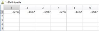

To avoid the bit shifting topic in the first place I use two vectors filled with int16 max values. The multiplication coefficients vector is shown below, it contains int16 max for the I part and zero for the Q part. It is loaded to the internal ram with the code below. This is of course executed before any HWA operation takes place.

A test vector is loaded to the HWA memory buffer and the HWA source address is pointing to it. This test vector contains int16 max value for all array entries. For testing I also optionally multiplied it with (-1).

So what I expect as result despite any shifting is that the Q part remains zero. Moreover I expect the I part to change the sign when the test vector only contains negative values. Unfortunately I cannot observe any of these behaviours. The output results just don't make very much sense for me currently.
So my question is, what I do wrong? Where am I missing something?
