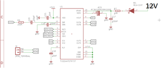

This is my schematic that I use. I am powering TUSS470 with 12V supply.

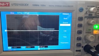

This is the signal when I read the OUTA pin. It is not changing at all when I changing the position of ultrasonic transducer .

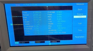

This is the signal when I read the OUT3 pin. This signal isn't changing either.
These signals only change when I touch the ultrasonic transducer  and It looks like this when I touched it or pressed it.
I tried to put 100 ohm resistor between OUTA and OUTB pin. Signals are changed but they still steady. This is the OUTA pin signal after when I put 100 ohm resistor.

    I took a quick look at the schematic provided, and most seems proper. My only comment is to ensure proper grounding practices between the transducer GND and the analog GND:
    A lack of proper separation can significantly influence the receive signal amplitude. Note, you will not likely be able to probe Out A and see the return echo on an oscilloscope. In most cases the noise will make the echo only distinguishable after the internal amplification and filtering stages.
    The 100-ohm resistor between OutA and OutB looks to be damping the response of the transducer excessively. We typically recommend using a potentiometer, or testing of various resistors to evaluate the optimal resistor for minimizing decay time.

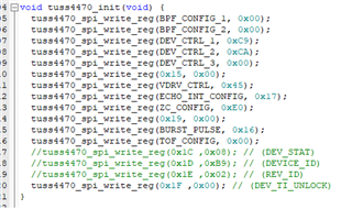

    My register configuration settings in init function I assume that you wanted to me explain why I use these configuration settings so I'll explain.
    I gave BPF_CONFIG_1 to 0x00 value because I am generating 40kHz frequency pulses and I use band pass filter.
    I gave BPF_CONFIG_2 to 0x00 value because when I looked at this forum people use this configuration value for 40kHz frequency.
    This is the tricky part I've used different configuration values for DEV_CTRL_1 and DEV_CTRL_2. I am not sure that I use correct values of these registers I was hoping that someone helps me to choose right values.  For example in DEV_CTRL_2 register should I Disable first logamp stage to reduce quiescent current and disable last logamp stage quiescent current or should I enable it?
    In my current configuration settings in DEV_CTRL_1 register I set LOGAMP_FRC bit  and I use 0x4 = 2.6×VOUT_SCALE_SEL+3.94×VOUT_SCALE_SEL V/V for LOGAMP_SLOPE_ADJ and I use 0.931 for LOGAMP_INT_ADJ .
    In DEV_CTRL_3 Register I use 0x00 value because I am using IO0 mode. You can see the other configuration settings by looking at the datasheet.
    I actually need the be sure about my configuration settings If you help me about that that would be great.
  • Hello Umut,
    Thank you for the additional information.
    For Dev_CTRL_1, it is fine to use 0x4 for the log amp. Sometimes the log amp requires tuning to obtain the proper dynamic range for the particular ultrasonic application. I recommend maintaining the current value for the time being, and we can look to see if altering this value improves performance in the future.
    Dev_CTRL_2 Is a register I might make changes to. I recommend enabling the first and last stage Log amp for testing purposes. Unless the application requires very low Iq, it is usually best to not disable some stages of the log amps. The LNA gain can also be an important field to adjust. I typically recommend starting at 15V/V for initial tests.
    Dev_CTRL_3 is set properly.

  • Hello Umut,
    I am happy to review your other register settings.
    BPF is setup properly.
    DEV_CTRL was mentioned in previous post
    VDRV_CTRL VDRV is set to 10V, meaning your supply voltage must be atleast 10.3V to operate properly. It is also possible to turn off the regulation of VDRV by using 0x20 in the VDRV_CTRL register.
    Echo_INT_CONFIG is setup properly
    ZC_CONFIG may need adjustment. I think the threshold is too low for most applications. Try to use 0x14 for the register as a start, and adjust the threshold if necessary to improve performance.
    BURST_PULSE is currently setup for 0x16 which is 22 in decimal. This is a bit high for most applications. I recommend decreasing this number a bit for testing purposes. This value is dependent on many factors, so it is difficult to evaluate the best value without application level testing.
    TOF_CONFIG is setup properly
    Please let me know if you have any questions.
