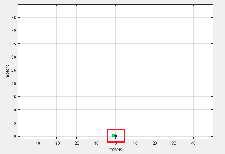

I have a unique application to track a reciprocating pump piston rod at close proximity from 20cm to 30cm. Piston rod has a Stroke Length of 30cm with 1 to 240 Strokes Per Minute (SMP) - i.e. a maximum linear speed 0.01m/s to 2.4m/s, but the motion is complex with sinusoidal acceleration and speed, field of view 90 to 120 degrees. A model of the Piston Rod has been made for evaluation purposes.
I have managed to connect together IWR6843AOPEVM, MMWAVEICBOOST & DCA1000EVM and understood how to use the mmWaveStudio.
But I need some help:
1. In post processing the ADC data collected with Matlab:
a) as the default graph scaling is to coarse for me to analyse the motion. Could you please advise me on how to post process the data with the graph window range zoomed in to +/-0.5m instead of +/-50m. i.e. with a magnification factor of 100
b) mmWaveStudio post processing is assumed for RX1 - RX4 in linear arrangement (a straight line ?). But the IWR6843AOP has them in a square arrangement. How to process the data with square receive antenna arrangement.
2. A guidance to set Chirp parameters in Sensor configuration for ultra short range i.e. in +/- 50cm. As I try to increase the chirp bandwidth closer to the maximum of 4GHz to increase the range resolution with high number of ADC samples (>1024) mmWaveStudio is crashing / non responsive.

  • HI, there:
    1) IF you are using radar studio for raw data capture, it is suggested to develop your own signal processing script for point cloud detection from the binary data, including develop your own angle of arrival algorithm and you can plot and zoom in the results as you desired.  On the other hand, you can use the OOB demo for AOP board as a starting point, which support point cloud detection for AOP antenna.  https://dev.ti.com/tirex/explore/node?node=AIHy77joqu3jXFmjqwkBKQ__VLyFKFf__LATEST ;  To understand the signal processing chain, you can either check the target code inside or go through the FMCW training video at: https://training.ti.com/intro-mmwave-sensing-fmcw-radars-module-1-range-estimation?context=1128486-1139153-1128542
    2) You can find some information about the chirp design at: https://e2e.ti.com/support/sensors-group/sensors/f/sensors-forum/1011679/iwr6843aop-how-to-proceed-in-designing-testing-chirps

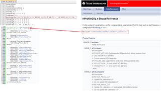

    Where do I find the information / description on attributes or parameters of profileCfg, chirpCfg and frameCfg?
    If I have to dive in to the DSS o MSS CCS project to find out the description, could you please point me to the right header file or the c file where this information is processed.
    Vithy
  • Hi, Vithy:
    The definition of each field for profileCfg chirpCfg and frameCfg can be found at SDK users guide located at: C:\ti\mmwave_sdk_xx_xx_xx_xx\docs\.  You need to download SDK package and install it under c:\ti\
    About the chirp design, you can find some information at: https://e2e.ti.com/support/sensors-group/sensors/f/sensors-forum/1011679/iwr6843aop-how-to-proceed-in-designing-testing-chirps

  • Hi Zigang,
    I have already downloaded and installed mmwave_sdk_03_05_00_04 and looked through the doxygen\html.
    I asked the question to you as I was struggling to find any direct correlation for the profileCfg in the  "AOP_6m_default.cfg" file which has float values to the struct rlProfileCfg integer values.
    Vithy

  • HI,
    That is why you need to go through the user guide and search for "profileCfg" to understand each field.  And once you understand each field, you can find more description through rlProfileCfg_t.
