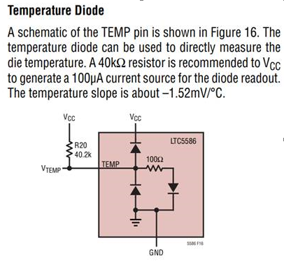

1. Our CPU's diode spec. is 10uA to 230uA and TMP451's remote sensor source current is 120uA. Does that mean TMP451 can be used for the CPU?

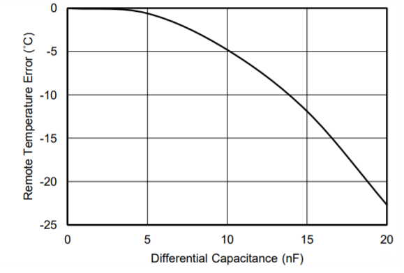

2. If so, How to calculate the current which pass through the filtering circuit? You may take the recommendation which are 100pF with 50 ohms values as example.

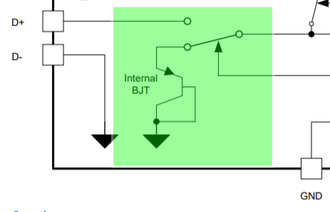

3. How fast is the internal BJT doing the switching?

5. Can TMP451 support reading the voltage slope of (-1.52mV/C) requirement? If not, may I have your recommendation?
