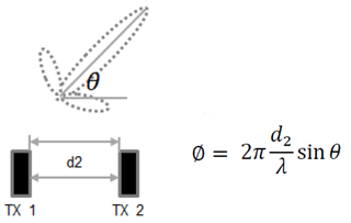

Can you provide the velocity or wavelenght (in units of distance instead of time)?
f = /λ

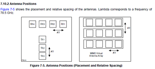

Hi Chris,
Antenna were designed around 78.5 GHz center frequency.
c = lambda * f where
c is the speed of light in a vacuum in m/s
lambda is the wavelength in m
f i s the frequency in Hz
lambda = c / f
lambda = 299792458 / 75.5E9
lambda = 0.00377097 m (about 3.771 mm)
