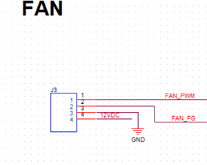

On the production line, we checked the characteristics of the FAN components. The definition of this standard is the same as the FAN specification which is 10% at maximum RPM. But it has several boards with more than 10%. We think we should consider the tolerance of LM63 to read RPM. Can you share what is the tolerance range?

    The tolerance of the PWM output should be +/-10%. What are you measuring in your application and if you can share your schematic along with your settings and conditions of measurement, that would be most helpful.
  • Follow you answer, It mean the RPM criterion shall be 20%(FAN tolerance+ PWM tolerance), is correct?
    But test RPM set to maximum mode, The PWM signal output is 100% duty cycle. I can see stable DC level without duty cycle on the oscilloscope. Is it mean no need consider tolerance value at PWM signal?

    3. Schematic

    Regarding your schematic - the I2C pullup resistors are weak (R131 and R132, set for 10k) would recommend you calculate the correct pullup value needed and I would not recommend installing buffer resistors on I2C line (R129 and R130) unless they are truly needed (usually they are not needed)
