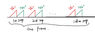

I am trying to achieve TX beamforming using AWR1843 and capture raw data with DCA1000 and mmWaveStudio.
Based on my understanding of  "Beamsteering for Corner Radar Reference Design" and use of mmWaveStudio, I have used the following steps to achieve beamforming, but I am not very sure. Is it possible to help me confirm whether these steps are correct or there are missing steps? Thank you!
My beamforming design is multiple beams within one frame:

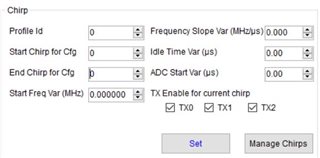

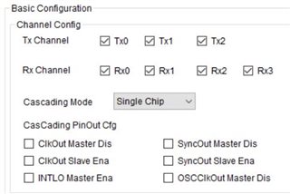

Step 1: Select all TX in channel config

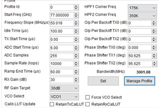

Step 2:  Set profile id 0 for angle at -60 degree with phase shifter [ 0, 50.625, 95.625] using the code provided:
theta_desired = -60;
m_ind = [0 1 2];
phaseInc = 5.625;
phaseTX_rad = 2*pi*(m_ind*sind(theta_desired));
phaseTX_deg = (phaseTX_rad)*180/pi;
phaseTX_deg_wrap = wrapTo360(phaseTX_deg);
phaseShifter = round(phaseTX_deg_wrap/phaseInc)*phaseInc;

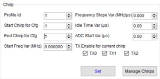

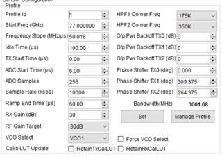

Step 3:  Set profile id 1 for angle at 60 degree with phase shifter [ 0, 309.375, 264.375]
Step 4: Configure chirp 0 using profile 0 and enable all TX sending signals simultaneously
Step 5: Configure chirp 1 using profile 1 and enable all TX sending signal simultaneously

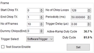

Step 6: Configure frame
Step 7: Data Capture
DCA1000EVM --> Trigger Frame
In addition, is there any way I can verify I am sending the waveforms in expect chirp design?
Looking forward to your reply!
