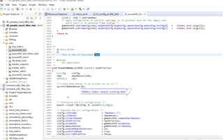

IWR1843BOOST: TRY To implement hardcode into the sensor
Part Number: IWR1843BOOST
I copied the cli.c file from OOB HCC of 6843ISK, and only change the include file, then the error happened as follow:

  • Hi Alec
    Thanks for your response.
    I would like to figure out the current method first.
    I added the header file, but still came out same error.
    Which step is missing?

    Did you include the corresponding macro into the predefined symbols for your project? For the header file you included in your screenshot, you would need to add "PROFILE_3d" to the predefined symbols in the project properties.
    This is due to the fact that the include statement for the headers are contained within a #ifdef
