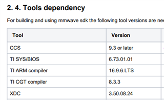

Hello Champs,
HW: IWR6843ISK+MMWAVEICBOOST
SW:  Industrial Toolbox 4.9.0
Demo:  Traffic Monitoring
The traffic_monitoring_68xx_demo.bin in prebuilt_binaries folder can run successfully.

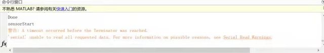

But when customer rebuilt the project and flashed the bin file,  the bin file could not run correctly.
Below is the error message.
Is there some special need to be taken consideration.
Customer used ccs 10.4.0,compiler 8.3.3 for dss,16.9.6.LTS for arm,xdctool 3.50.8.24,bios 6.73.1.01
He also tried to use compiler 8.1.3, but it still failed.
Thanks.

  • Hi Vaibhav,
    Thanks for your reply.
    The HW and SW setup is ok because customer can run the bin file in prebuilt_binaries. But he failed to run he bin file which the rebuilt the project.
    Besides, he rebuilt the
    Traffic Monitoring in industrial toolbox4.8, the new bin can run correctly.
    So I wondered if there is a bug in the Traffic Monitoring demo in toolbox 4.9.
    Thanks.
    Rgds
    Shine
