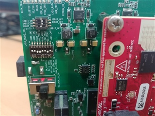

    SW2 setting is this.

    I run to mmWavelink_example.exe. refer to this post.
    https://e2e.ti.com/support/sensors-group/sensors/f/sensors-forum/958388/awr2243boost-mmwavelink_example-exe-with-dca1000evm-and-awr2243boost
    Problem is SOP jumper, and I ON the jumper only SOP0.
    But DCA1000EVM_CLI_Control + DCA1000EVM_CLI_Record is not working.
    I sovled this problem.
    I execute "DCA 1000 EVM Control, Record" and "mmwavelink_montroring.exe" same time.
    I did not understand what the application did.
    "DCA1000EVM Control and Record" is only control DCA1000EVM. It is not Contorol AWR2243.
    but I thought. DCA1000EVM did control AWR2243.
