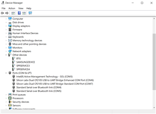

    Can you send us a screenshot of your device manager window here? What do you see there when you connect the device?

  • Hello Ishita,
    Thank you for your quick response. This is a screenshot of my device manager window:
    Also, here is a screenshot of the driver tab for the COM port:
    I do not have a DCA1000 capture card, as I am interested in the processed (point cloud) data as opposed to raw data. I am under the impression that mmWave studio should work when I only connect the IWR6843ISK; is this not the case?

  • Hello Max,
    This error is corresponding to the fact that the FTDI drivers weren't installed properly, and to install them properly and run mmWave Studio for the first time, you would either need a DCA1000 capture card or mmWave Dev Pack/ICEBoost.
    But anyhow, mmWave studio will not provide you with the point cloud data. This tool is architected mainly for raw ADC data capture.
    For processed point cloud data, you would need to run the mmWave SDK demo application which as you mentioned is running properly.
