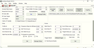

On radar sensor radar AWR2243 I need to run DCA1000 to capture time in infinite mode :
I use mmwave  studio --> sensorconfig-->trigger dca use cf.json file in PostProcess folder as below, and set No Of Frames=0  in SensorConfig then set, for infinite trigger or loopa of capturing data but it does not work and after some captured data The DCA1000 stops and we should push Trigger button and re run it.
How can I have  infinite dca capturing data (no duration)???
parameters which set.
