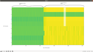

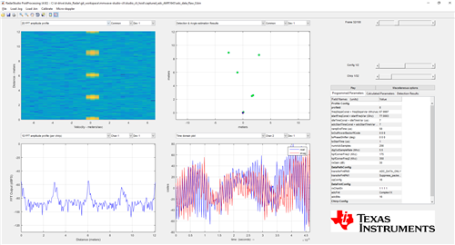

I am using Studio_CLI to configure AWR1642Boost with DCA1000EVM in order to capture raw data from ethernet port on DCA1000. I managed to config the radar and receive the response with 'Done' at the end. But when I arrange and look at the received raw data (plotted for one loop), I see a constant, nonchanging data added to the raw data. When I configure the radar with same configuration and mmwave Studio I don't see such behavior. My assumption is that the raw data format should be the same in both cases, so wondering why I see this extra bytes added to the raw data.
