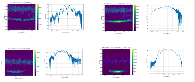

I have been testing the MMWAVCAS-RF which I found to be producing very strange results. Therefore, I compared it in a similar scenario to the IWR6843 to evaluate and compare results. IWR6843 has always provided measurement results as expected by theory.. This is not the case with the cascaded system.
Attached you can find a small presentation I setup for more detailed explanation of the measurements. Hereby I provide a brief overview. I would like to share my observations with you and ask for your support of how to fix or exchange the part since I believe that it is faulty.
Measurement description:
The radar sensor, either IWR6843 or MMW-RF-CAS is placed on a sliding platform which moves horizontally and tangentially to the target,  with tangential length of 60cm. A measurement is performed with one standard trihedral corner reflector with rib length of 5cm at various distances. First at 0.2m and then at 0.6m, measured when target is straight against the sensor. The sensor is aligned in the vertical dimension as the target center is aligned to the midpoint of the Tx and Rx antenna. The raw data is Fourier transformed and the resulting range profiles are stacked next to each other in order to form a two dimensional image, where range profiles are plotted as a function of time. The chirp parameters for both devices are set to be the same, with the only difference that the cascaded system transmits in the MIMO mode(as provided by the lua script) ,while the IWR transmits with only one transmitter. RAM is placed on the wall behind the target.
The theoretical expectation is to observe a smooth curved line due to the range migration of the target and the tangential motion. This is the case for the IWR6843 but not with the cascaded system.

               It appears the observed results are similar, however the data captured on the Cascade setup because of frame loss is not that smooth in plot as 6843. For the frame drop can you please try lowering the data rate from 600Mbps to 450Mbps.
  • Hello Abhed,
    Sorry but I cannot be convinced how the data is similar, as first of all the reflected power appears to be much lower, in the order of the magnitude of the RAM placed behind the corner reflector. Secondly, there is about 5% data loss, so only a few of the samples shall be disrupted but in the images you can see that this is not the case at all.
    Finally, I made those measurements with 225Mbps data rate as indicated in other forum entries and in the documentation but this does not change anything in terms of data loss..In this case this is also the lowest sampling rate - 2MHz, so I still do not understand why data loss would occur. Therefore, my conclusion is that there is some defect with the RF board or the data acquisition board. If you have some suggestions of what kind of measurement I can perform to be convinced that there is no problem within the hardware I would be happy to perform that. Otherwise, I would like to know what is the procedure to send back this hardware and exchange for a new one such that I can continue with my developments.

  • Would you be able to support my issue.. Please have a look at my latest entry, where I show that the frame drops are probably not the problem... Any idea if I can setup a test or a measurement to make sure that everything is ok with the hardware? Otherwise, can you please advise me on a return and exchange procedure?
    Please clarify below points.
    1. Are you using studio in both the cases? What is the ADC mode being config in both?
    2. Have you tried using single TX on Primary/master device making it exactly same config as 6843?
    3. How do we see the amplitude difference between the two cases?
  • Hi Abhed,
    1. yes, I am using mmwave studio in both cases. In both cases I use complex 1x adc sampling mode.
    2. Yes, I have tried using 1 transmitter and all receivers in the cascaded case. In that experiment I setup transmit from the master chip and receive all other channels at all chips. That means only one chirp per frame from the master. HOWEVER,  I that case I got an error - for some reason it is not possible to do that and you can only configure 2 or more chirps per frame from master chip, tx 0.
    3. Please see the images below. In the plots on the left you see the results from the cascaded system, where the 2d images are the range profiles in linear scale and in the plots to the right are the cuts through the maximum power range bin, e.g., the one that corresponds to the real range of the target. In the plots you see in dB.
    2. Can you please share a snapshot of the error?
    3. It still doesn't explain the amplitude difference. If we have an exact setup(TX and profile), measurement should match.
    I will share my answers on Monday, when I will make those measurements. One question regarding 2... There you mean to set the mmw-cas only with the master chip activated?
  • Hi Abhed,
    Unfortunately due to errors in studio I cannot replicate the measurement from the IWR6543 system on the MMW-CAS. Due to some reason the cascaded system cannot be set such that it sends only one chirp per frame. Attached you can find the lua shell script (disregard the Configure_Chirps function, the chirp config is around line 753) that I used in order to replicate the measurements and in the attached text file you can find the output of studio. hereby is the is the error itself also seen in the text file:
    [13:23:23] Create Application Response from Capture Card timed out!!
    [13:23:23] TDA ARM Failed
    Apart from that I also tried to manually set the system through the GUI and trigger the data, but to no success, always the same error from above.
    Furthermore, I tried to perform measurements with the same settings but using two identical chirps per frame, I add the second chirp as:

    That way I could record data but still I have files with different sizes for each measurement !??? which I really do not understand even though only one chip is recording data and the adc sampling rate is the lowest 2MHz? Why is the system not recording all data?
    Apart from that the processed results (below), when I use only the first of the two chirps, which is the closest I can get compared to the IWR system setting.

    RadarAPI]: TDAStatusCallback Event Registered
    [13:21:27]  [RadarAPI]: registerTDAStatusCallback Status: Passed
    [13:21:27]  [RadarAPI]: ar1.ConnectTDA("192.168.33.180", 5001, 15)
    [13:21:27]  [RadarAPI]: Device 32 : CAPTURE_RESPONSE_ACK Async event recieved() with status 0
    [13:21:27]  [RadarAPI]: Device 32 : CAPTURE_RESPONSE_VERSION_INFO Async event recieved() with status 0. TDA Version : REL_VISION_SDK_03_07_01_00 Aug  5 2019 15:04:45[13:21:27]  [RadarAPI]: Device 32 : CAPTURE_RESPONSE_ACK Async event recieved() with status 0
    [13:21:29]  [RadarAPI]: Device 1 : CAPTURE_RESPONSE_ACK Async event recieved() with status 0
    [13:21:29]  [RadarAPI]: ConnectTDACaptureCard Status: Passed
    [13:21:29]  TDA Capture Card Status : CONNECTED!
    [13:21:34]  [RadarAPI]: Device 1 : CAPTURE_RESPONSE_ACK Async event recieved() with status 0
    [13:21:34]  [RadarAPI]: ar1.FullReset(1)
    [13:21:34]  [RadarAPI]: Status: Passed
    [13:21:34]  [RadarAPI]: ar1.SOPControl_mult(1,4)
    [13:21:35]  [RadarAPI]: ar1.PowerOn_mult(1, 0, 1000, 0,0)
    [13:21:36]  [RadarAPI]: Status: Passed
    [13:21:36]  [DeviceId-0] MSS power up done async event received!
    [13:21:38]  [RadarAPI]: ar1.DownloadBSSFw_mult(1,"C:\\ti\\mmwave_dfp_02_02_03_01\\firmware\\xwr22xx_metaImage.bin")
    [13:21:38]  [RadarAPI]: ar1.DownloadBssFwOvSPI_mult(1, C:\\ti\\mmwave_dfp_02_02_03_01\\firmware\\xwr22xx_metaImage.bin)
    [13:21:44]  [RadarAPI]: ar1.SelectChipVersion("AR1243")
    [13:21:44]  [RadarAPI]: Status: Passed
    [13:21:44]  [RadarAPI]: ar1.deviceVariantSelection("XWR2243")
    [13:21:44]  [RadarAPI]: ar1.frequencyBandSelection("77G")
    [13:21:44]  [RadarAPI]: ar1.SelectChipVersion("XWR2243")
    [13:21:44]  Device Status : XWR2243/ASIL-B/SOP:4/ES:1.1
    [13:21:44]  [RadarAPI]: ar1.RfEnable_mult(1)
    [13:21:44]  [DeviceId-0] BSS power up done async event received!
    [13:21:58]  [RadarAPI]: ar1.ChanNAdcConfig_mult(1, 1, 0, 0, 1, 1, 1, 1, 2, 1, 0, 0)
    [13:21:59]  [RadarAPI]: Status: Passed
    [13:22:00]  [RadarAPI]: ar1.LPModConfig_mult(1, 0,0)
    [13:22:00]  [RadarAPI]: Status: Passed
    [13:22:01]  [RadarAPI]: ar1.RfInit_mult(1)
    [13:22:02]  [DeviceId-0] RF Init async event received!
    [13:22:02]  [RadarAPI]: Status: Passed
    [13:22:02]  [RadarAPI]: Time stamp, Temperture: 17700,30; APLL Status, Update: 1, 0; SynthVCO1 Status, Update: 1, 1; SynthVCO2 Status, Update: 1, 1; LODist Status, Update: 1, 1; RxADCDC Status, Update: 1, 1; HPFcutoff Status, Update: 1, 1; LPFcutoff Status, Update: 1, 1; PeakDetector Status, Update: 1, 1; TxPower Status, Update: 1, 1; RxGain Status, Update: 1, 1; TxPhase Status, Update: 1, 1; RxIQMM Status, Update: 1, 1;
    [13:22:17]  [RadarAPI]: ar1.DataPathConfig_mult(1, 512, 1216644097, 0)
    [13:22:17]  [RadarAPI]: Status: Passed
    [13:22:20]  [RadarAPI]: ar1.LvdsClkConfig_mult(1, 1,1)
    [13:22:20]  [RadarAPI]: Status: Passed
    [13:22:21]  [RadarAPI]: ar1.CSI2LaneConfig_mult(1, 1, 0, 2, 0, 4, 0, 5,0,3,0, 0)
    [13:22:21]  [RadarAPI]: Status: Passed
    [13:22:29]  [RadarAPI]: ar1.ProfileConfig_mult(1, 0, 77, 100, 6, 60, 0, 0, 0, 0, 0, 0, 29.982, 0, 256, 10000, 0, 0, 94)
    [13:22:29]  [RadarAPI]: Status: Passed
    [13:22:57]  [RadarAPI]: ar1.ChirpConfig_mult(1, 0, 0, 0, 0, 0, 0, 0, 1, 0,0)
    [13:22:57]  [RadarAPI]: Status: Passed
    [13:23:06]  Test Source Already Disabled...!!!
    [13:23:06]  [RadarAPI]: ar1.DisableTestSource_mult(1,0)
    [13:23:07]  [RadarAPI]: Status: Passed
    [13:23:07]  [RadarAPI]: ar1.FrameConfig_mult(1, 0, 0, 1000, 1, 40, 0, 1)
    [13:23:09]  Test Source Already Disabled...!!!
    [13:23:09]  [RadarAPI]: ar1.DisableTestSource_mult(1,0)
    [13:23:09]  [RadarAPI]: Status: Passed
    [13:23:09]  [RadarAPI]: ar1.FrameConfig_mult(1, 0, 0, 1000, 1, 3, 0, 1)
    [13:23:10]  Test Source Already Disabled...!!!
    [13:23:10]  [RadarAPI]: ar1.DisableTestSource_mult(1,0)
    [13:23:10]  [RadarAPI]: Status: Passed
    [13:23:10]  [RadarAPI]: ar1.FrameConfig_mult(1, 0, 0, 1000, 1, 3, 0, 1)
    [13:23:12]  Loops Remaining : 1
    [13:23:12]  Starting TDA ARM...
    [13:23:12]  [RadarAPI]: ar1.TDACaptureCard_StartRecord_mult(1, 0, 0, Measurement_20220117_1, 0)
    [13:23:12]  Device 0 - Configuring TDA with Width : 2048 and Height : 1
    [13:23:12]  [RadarAPI]: Device 0 - setWidthAndHeight Status: Passed
    [13:23:12]  [RadarAPI]: Device 1 : CAPTURE_RESPONSE_ACK Async event recieved() with status 0
    [13:23:12]  Device 1 - Configuring TDA with Width : 0 and Height : 0
    [13:23:12]  [RadarAPI]: Device 1 - setWidthAndHeight Status: Passed
    [13:23:12]  [RadarAPI]: Device 2 : CAPTURE_RESPONSE_ACK Async event recieved() with status 0
    [13:23:12]  Device 2 - Configuring TDA with Width : 0 and Height : 0
    [13:23:12]  [RadarAPI]: Device 2 - setWidthAndHeight Status: Passed
    [13:23:12]  [RadarAPI]: Device 4 : CAPTURE_RESPONSE_ACK Async event recieved() with status 0
    [13:23:12]  Device 3 - Configuring TDA with Width : 0 and Height : 0
    [13:23:12]  [RadarAPI]: Device 3 - setWidthAndHeight Status: Passed
    [13:23:12]  [RadarAPI]: Device 8 : CAPTURE_RESPONSE_ACK Async event recieved() with status 0
    [13:23:12]  Sending Frame Periodicity of 3 to TDA..
    [13:23:12]  [RadarAPI]: Status: Passed. Frame Periodicity sent to TDA
    [13:23:12]  [RadarAPI]: Device 32 : CAPTURE_RESPONSE_ACK Async event recieved() with status 0
    [13:23:13]  Sending Capture Directory with name /mnt/ssd/Measurement_20220117_1 to TDA..
    [13:23:13]  [RadarAPI]: Status: Passed. Capture Directory sent to TDA
    [13:23:13]  [RadarAPI]: Device 32 : CAPTURE_RESPONSE_ACK Async event recieved() with status 0
    [13:23:13]  Sending File Allocation of 0 files to TDA..
    [13:23:13]  [RadarAPI]: Status: Passed. File Allocation sent to TDA
    [13:23:13]  Sending Enable Data Packaging (0 - 16-bit; 1 - 12-bit) with value of 0 to TDA..
    [13:23:13]  [RadarAPI]: Status: Passed. Enable Data Packaging sent to TDA
    [13:23:13]  Sending Number of frames to capture with value of 0 to TDA..
    [13:23:13]  [RadarAPI]: Status: Passed. Number of frames to capture sent to TDA
    [13:23:13]  [RadarAPI]: Status: Passed for notifying TDA about Creating Application
    [13:23:23]
    [13:23:23]  ***Script completed successfully.***
          Can you please refer this thread for operating the cascade EVM in single chip mode?
    https://e2e.ti.com/support/sensors-group/sensors/f/sensors-forum/895738/mmwcas-rf-evm-can-i-set-the-anyone-of-the-4-xwr2243-chip-as-the-master-or-single-chip-for-testing
    From the error of TDA ARM failed it appears the TDA ARM did not happen properly.
    Yes I have already referred to this topic. I am asking questions in this forum because I experience issues with the system which could not resolve by documentation or searching similar topics in the forum.
    Indeed TDA ARM failed, I can see that from the error . I am seeking your support to understand why this happens and how to resolve it. You are stating the facts but not providing solutions or a way to test where the problems comes from and how to solve them.
    If you cannot provide support to my issues please bring in someone else who is capable of that. I expect that you or someone else in TI provides technical knowledge and input to resolve the issues and not only refer me to documents, which I can and do look up myself.
         The reason for referring you to the above link was to tell you that the EVM can be made to work in Single Chip Mode.
    Additionally the procedure listed there apart from the mmWave studio cascade user guide/cfs-file/__key/communityserver-discussions-components-files/1023/5621.mmwave_5F00_studio_5F00_cascade_5F00_user_5F00_guide.pdf
    I am sure if you relook at the procedure and steps you will be able to overcome the error of TDA ARM failure.
    With cascade setup being controlled through TDA2, any small miss in the step or detail in configuration can lead to failure in over all capture.
  • Yes, thank you I see that you are again referring to documentation that I have already followed to the point. Did you read my post at all, where I sent you the lua shell and the output. I will repeat here again to make it again clear:
    - I can setup the device in single chip mode and record data but only with two chirps per frame. If I do one chirp per frame it does not work... I get an error. Why is that? This does not seem to be normal behavior. For the IWR6843 I can easily set one chirp per frame and use that configuration for my measurements. Is that some kind of limitation of the cascaded system and if so why is it not documented. If not a limitation is it a bug in your software or the hardware I have is defect?
    You still did not answer my question about the data loss. I think it is completely unacceptable that I cannot get a measurement without loosing data even if I use the recommended settings(low clock rate) and the lowest ADC rate.
          So the way I understand the issue right now at your side is as your are not getting the smooth range doppler plot with cascade system(as compared with IWR6843 setup). For debugging that we are trying to make the configuration of both setups exact.
    But for the cascade setup you are not able to configure the single chip with one chirp per frame configuration as it throws error.
    Presuming you have referred all the documentation available and have also followed it correctly, What I feel is TDA2 frame size might be the point of failure. This is supported by the information that when you configure more than 1 chirp per frame you dont see any capture failure in singel chip mode as then the frame size becomes 4096.
    I would suggest here to have a capture made with 2chirps per frame on singel chip mode on cascade device and similarly for the iwr6843 also and check.
