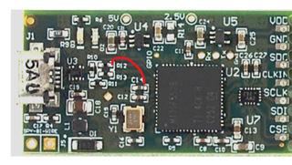

    Thank you for posting what worked for you. I will add that if your board is unable to perform a firmware update through the Sensing Solutions GUI, you can also try re-flash the board following the instructions in this FAQ post. For the LDC1101EVM, it should be C14 and R12 that need to be shorted:
