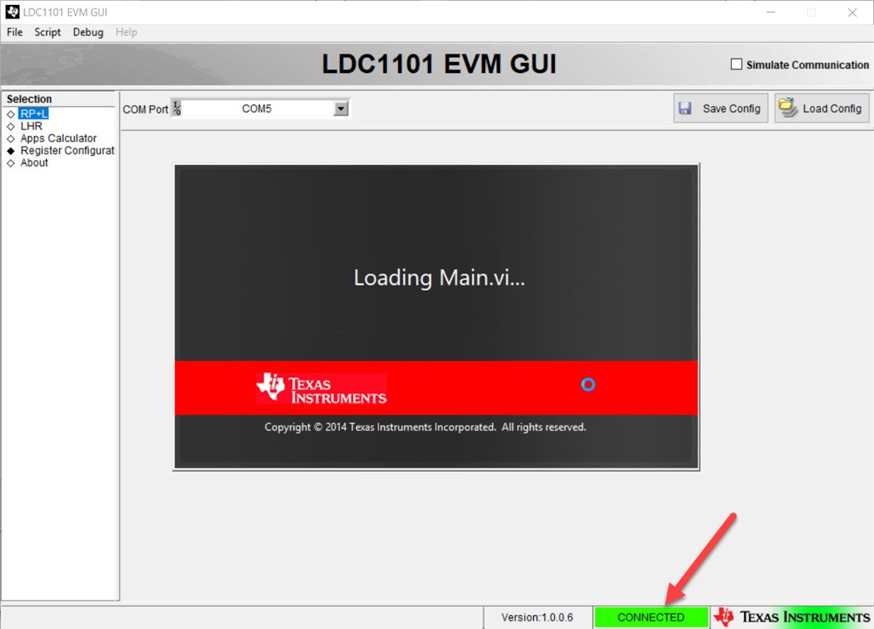

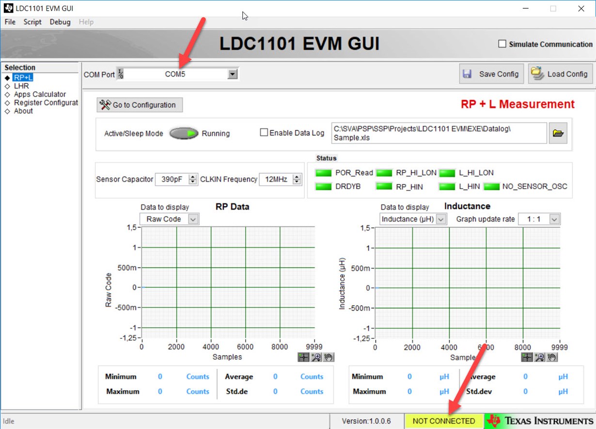

    I installed the LDC1101EVM and additional the NI-VISA Run Time installation patch as administrator. Unfortunately, the issue remains unsolved... the device stays "NOT CONNECTED" at the GUI.

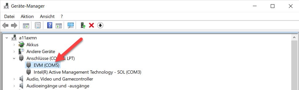

    At start-up of the GUI it shows "CONNECTED" for some (2..3) seconds, then it switches to "NOT CONNECTED" (see screenshots below). The device is connected via COM5 and is recognized as "EVM" (drivers are working, see screenshot below). I also tried to run the GUI as administrator, no changes. I did the whole procedure again with a second computer, same result.

    I haven't recreated the issue yet but I did notice something we can try to do to fix this. The EVM for me shows up as a Serial Device rather than as an EVM when looking in device manager. Can you try uninstalling the device and then reconnecting the EVM. Hopefully reinstalling the driver here will solve the issue.
  • Hello Justin,
    I followed the recommended actions regarding the driver in device manager. At the end the device LDC1101EVM was recognized as "USB Serial Device" by Windows. Unfortunately this did not resolve the issue.

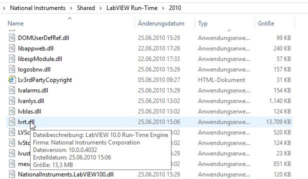

    Sorry this issue is so persistent for you. What version of the LabView runtime are you using? You may need to update to the latest version in order for this to work. Once updated, I would reinstall the patch just to make sure it is applied.
  • Hello Justin,
    I'm sorry to bother you again. I am using LabVIEW 10.0 Run-Time Engine (see screenshot below). Is that ok? Or do I have to update? Where do I get the latest version?
    Patrick
  • Hello Patrick,
    That should be fine. I use the 2010 SP1 runtime which you can download from here: www.ni.com/.../download.labview-runtime.html

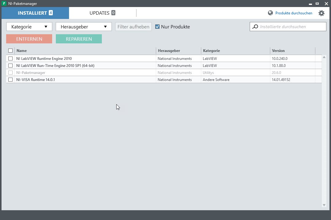

    We also want to check the NI-Visa Runtime. You can do this by opening NI Package Manager on your computer (this should have installed with the runtime engine) Here is what I have for my versions:
    Let me know what you have for this.
  • Hello Justin,
    I installed NI-LVRT 2010 SP1. These are my versions:
    Patrick
  • Hello Patrick,
    Your install matches mine. At this point, I think we should consider trying a different EVM or different computers. I know you mentioned trying different computers in the beginning, but have you tried a different computer with the latest software suggestion?
