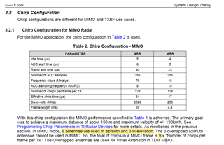

  The frame length of MRR mode in Table 2 of Design guide — TIDEP-01012  makes me confused.
To my understanding, the frame length is calculated as
        FrameTime = (RampEndTime + IdleTime)  x (NumOfChirps per frame per Tx) x NumTx.  (Eq, A)
   Using the chirp configuration and there are 9 Tx antennae used in MRR mode, we can obtain frame length as
        (23 + 4)us x 128 x 9 ~ 31.1ms.
However, Table 2 shows the frame length of MRR mode is 4.4ms. Do I miss something?
