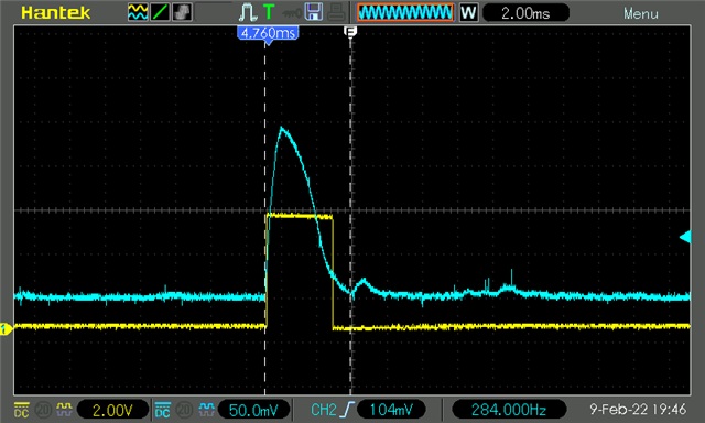

I have a TUSS4470 based circuit being used with a transducer from Prowave -- running in direct drive mode.
I am clearly getting a readable echo signal on the ADC as I can see a signal register on the ADC waveform. However, the signal is quite weak and not as differentiated from ground even after tuning the LNA.
The following are the discretes in the circuit:
  • C_INN: 0.1uF
  • C_INP: 0.1uF
  • R_INP: 330Ohms
I have tried a damping resistor as well to reduce the "ringing" time, but that does not help much in differentiating the echo, which is expected.
My register settings are:
0x10 BPF_CONFIG_1 0x00
0x11 BPF_CONFIG_2 0x00
0x12 DEV_CTRL_1 0x8F
0x13 DEV_CTRL_2 0xC6
0x14 DEV_CTRL_3 0x00
0x16 VDRV_CTRL 0x4F
0x17 ECHO_INT_CONFIG 0x10
0x18 ZC_CONFIG 0x14
0x1A BURST_PULSE 0x04
0x1B TOF_CONFIG 0x01
I have tired adding a damping resistor between the two leads of the transducer, but need 4.7k to help reduce the ringing time. As you can perhaps see from the scope capture below, the signal from a rather large target is barely registering at some 35mW after the LNA. What could I be doing wrong in the LNA settings?
Thanks in advance for your help

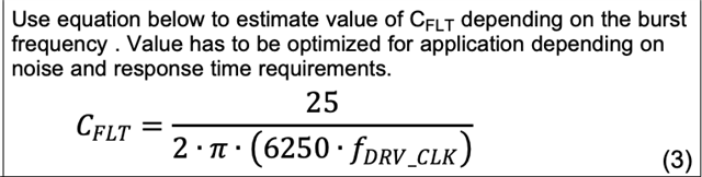

  • Reading the datasheet closer, I see that my choice for C_FLT might not be correct. I currently have a 0.1uF C_FLT and using the equation in the datasheet it should be more like 16nF!
    Is this perhaps the culprit?
  • Hello Rajeev,
    Welcome to the E2E forum.
    I absolutely agree with your analysis.
    The large CFLT value is likely slowing down the signal path to a point where the receive echo is difficult to measure
    Try changing CFLT to the calculated value, and let me know if that improves the response.
    Jacob
