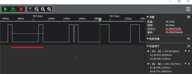

While working with the customer, we found out that the PWM-OUT duty cycle will automatically changed in SW-DCY mode suddenly.
The reproduce steps are below.

  1. Why PWM goes to 100% high-level?
  2. Why PWM duty cycle goes to half from 30% to 15%?

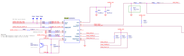

Please reference the waveform and schematic as below. Thank you.
Waveform: Ch1 PWN-OUT, Ch2 TACH.
Schematic:

    See the description for the TACH-MODE bit, which you cleared when writing default value to register 0x01. If your fan requires PWMINV=1, it should be set before writing TACH-MODE=0 for the measurement to work.
    When the TACH-MODE bit is cleared ('0'), the PWM-Out pin is forced ON during RPM measurement, and internal correction circuitry is enabled to correct the error caused by this extra duty cycle.
    Can you double check the 15%? Setting the PWMINV should make 30% appear to be 70% and vice-versa. Read back the configuration registers to verify them. 15% might make sense if you were using the default FDRC=01.

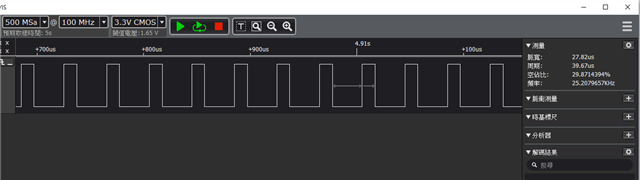

    When they set TACH-MODE=0, 1
    The waveform shows the PWM actually 15% duty cycle after measurement. It will auto resume 30% after 101ms.

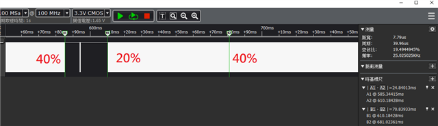

    Zoom in
    Set DCY=40%. B1-B2 is 70ms, shorter than 30% situation.
    We think this behavior is “and internal correction circuitry is enabled to correct the error caused by this extra duty cycle”.
    Is that correct? Thank you.
    Mike
  • Mike,
    I'm confused. That quote 'internal correction circuitry is enabled to correct the error caused by this extra duty cycle' is associated with TACH-MODE 0. Does TACH MODE 1 resolve the customer issue?

    Thanks for the support on this, the should solve the customer question.
    Mike
