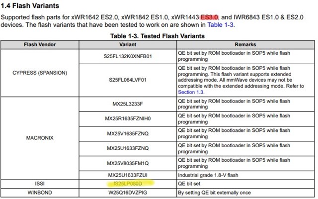

customer use the IWR1443(rev3.0) with the MX25V8035 from Macronix and it is running well. Due to delivery issues they want to use IS25LP080D from ISSI. Unfortunately, it doesn't work. In the app note "Serial Data FLASH Supported" (SPRACH9C), the distinction is "QE bit set by ROM bootloader in SOP5" for the Macronix and "QE bit set" set at the ISSI. What exactly does that mean?

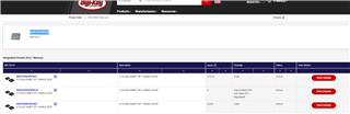

           For the MX25V8035 parts shows in the Digikey distribution channel as parts are available.
    If you need any help from the Macronix team to ship the part to your customer place directly we could enable that channel to overcome supply problems. Do let us know.
    For the IS25LP080D Quad enable bit need to be set high to be able to operate in the Quad SPI mode.
    It appears that by default Quad enable bit is not set, this need to be enabled to operate in Quad mode.
    You could request manufacturer to set it by default  before shipping the part, or enable it by other means, As this bit is non-volatile bit, once it's enabled then it would be fine.

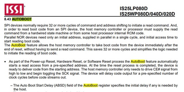

    The IS25LP080 had an additional autoboot mode that is made special for this kind of boot-experience and that has some register for timing and address, because it is working without a special read-command.
    Is this mode used by the IW1443? And in case it is used, did you have some example value for the Start Delay?

        Thank you for the confirmation, Yes, that was my first suggestion and also stated in the app-note, QE bit need to be set, By default from the manufacturer it's not.
