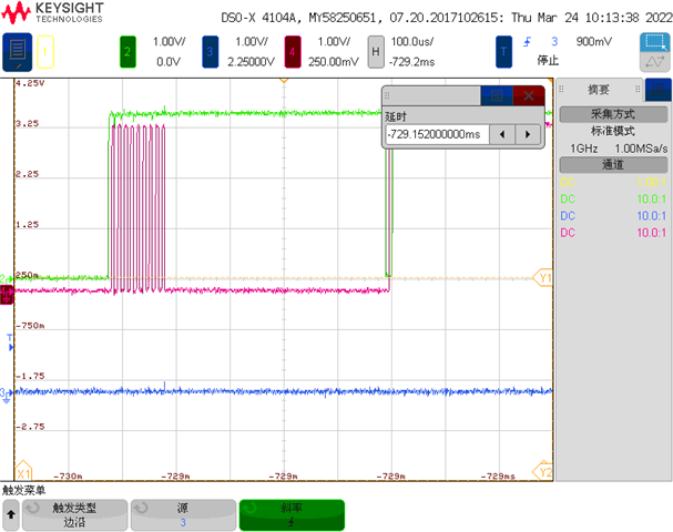

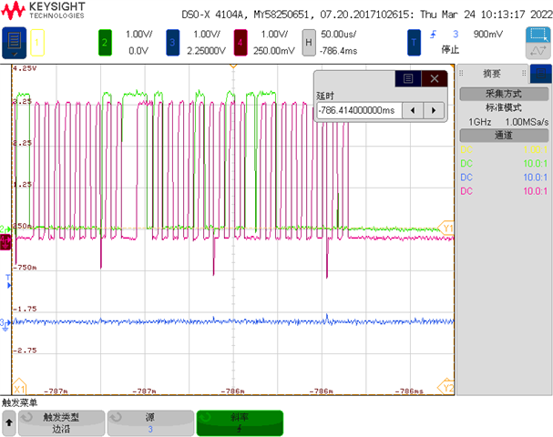

we have using an Arduino microcontroller to read the configuration register, and there is only opt3001 has connected to the microcontroller, the test program is continuously read the value of the configuration register, the value is correct at first, but after it runs for sixteen days, it value is become invalid,
the value of configuration register is toggles between 0xFE9F and 0xFE1F. when we reboot opt3001, the read value is normal again(The value is 0xc810).

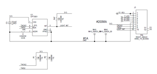

3. The Arduino hardware schematic is as below:
3872.Arduino_Uno_Rev3-schematic.pdf
AMBIENT.pdf
