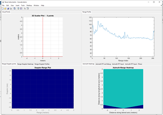

I was going through the Cascade Radar Usecases: 4 4 AWR1243 Capture + Radar Object Detect (DSP) (MIMO) + Null in Processor SDK – Radar (v03.08) User Guide, page 32.
I was able to go through the settings from the serial ports and run radar_cascade_demo(). However, there are not pointclouds.
I guess this is because I didn't create the CC.mat (Calibration) file. I was confused how to generate CC.mat file.

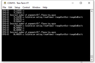

I entered 'c' in the terminal,  it showed me 'Calibration setting (<numFrames> <rangeStarBin> <rangeEndBin>)'
However, the CC.mat file was not generated.
Could you give me some suggestions on how to correctly generate CC.mat file? Or what are the procedures to do it?
