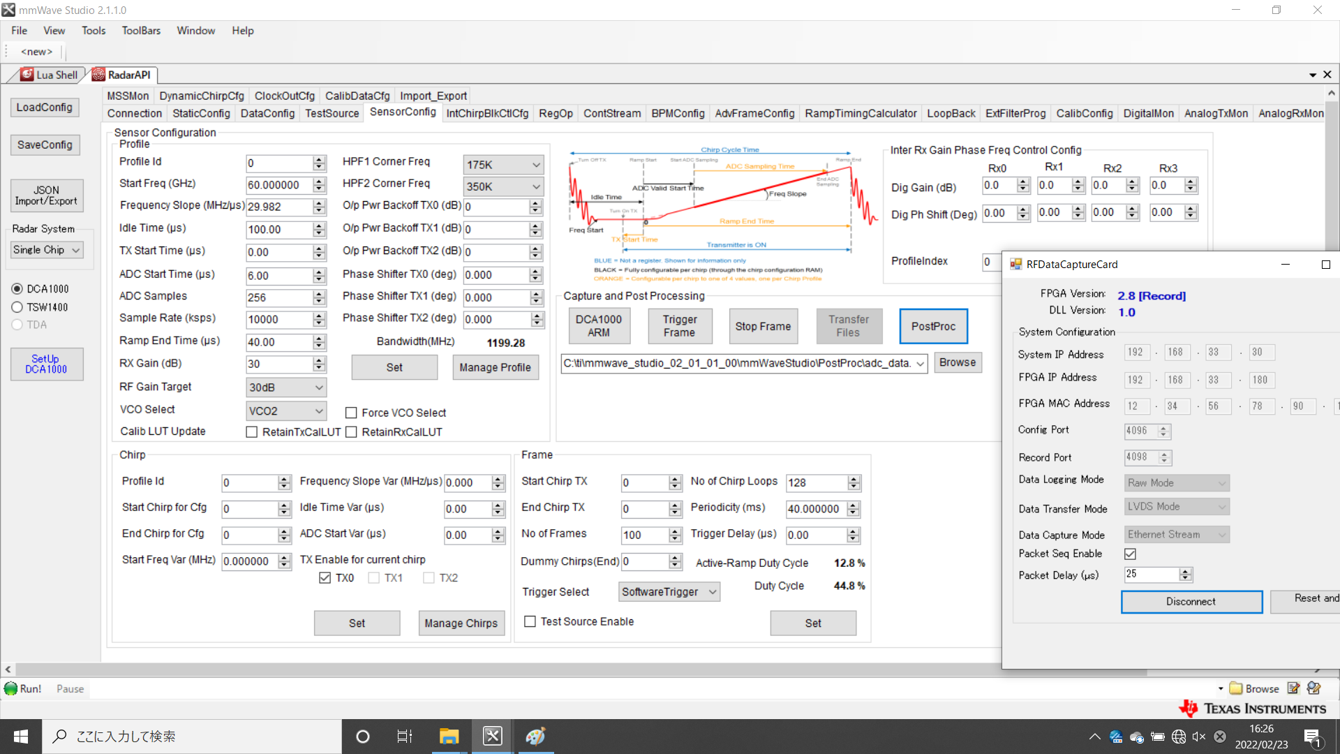

The setting of BandWidth understands the thing by the setting of FrequencySlope and RampEndTimen.
Therefore I changed RampEndTime and input (40μsec ← 60μsec) In BandWidh of Sensor Config,
 "1798.92MHz ⇒ 1199.28MHz" and indication were changed (Frequency Slope is 29.982MHz/μsec),

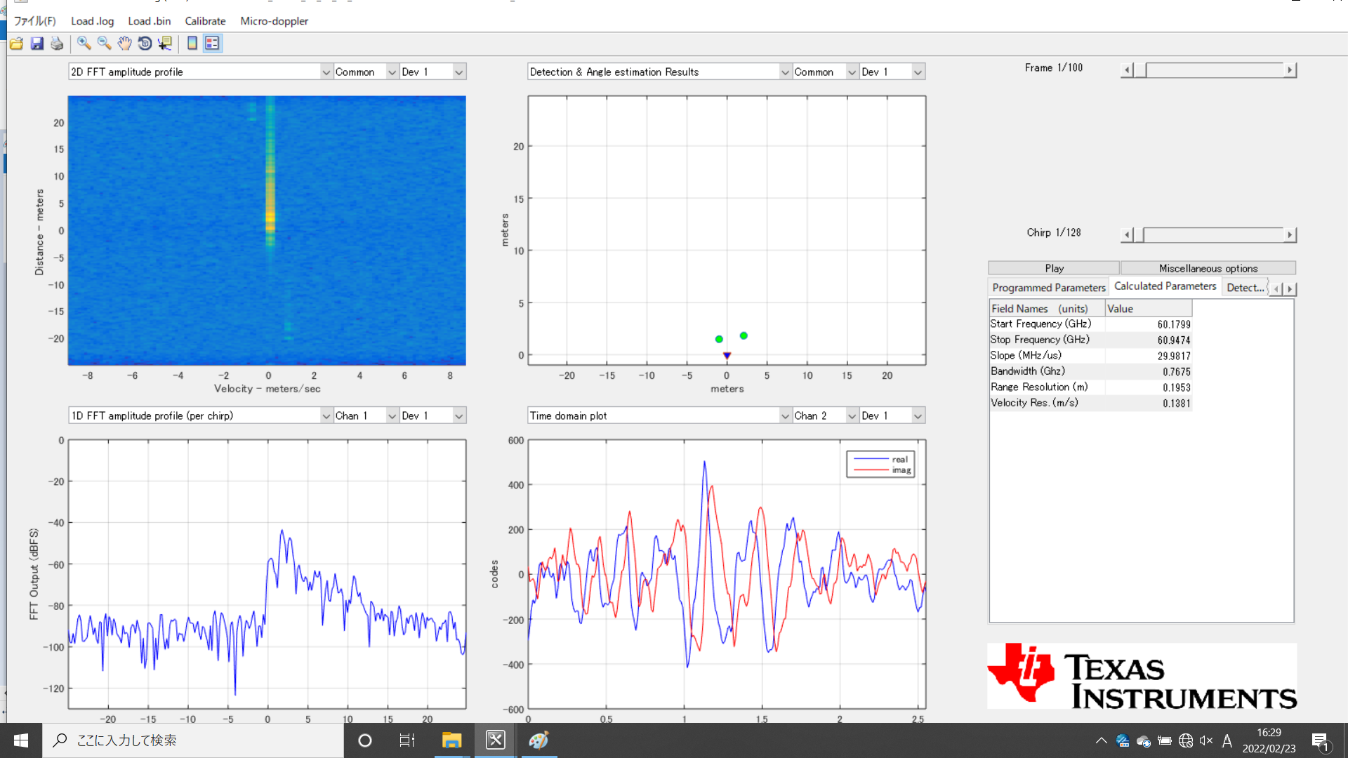

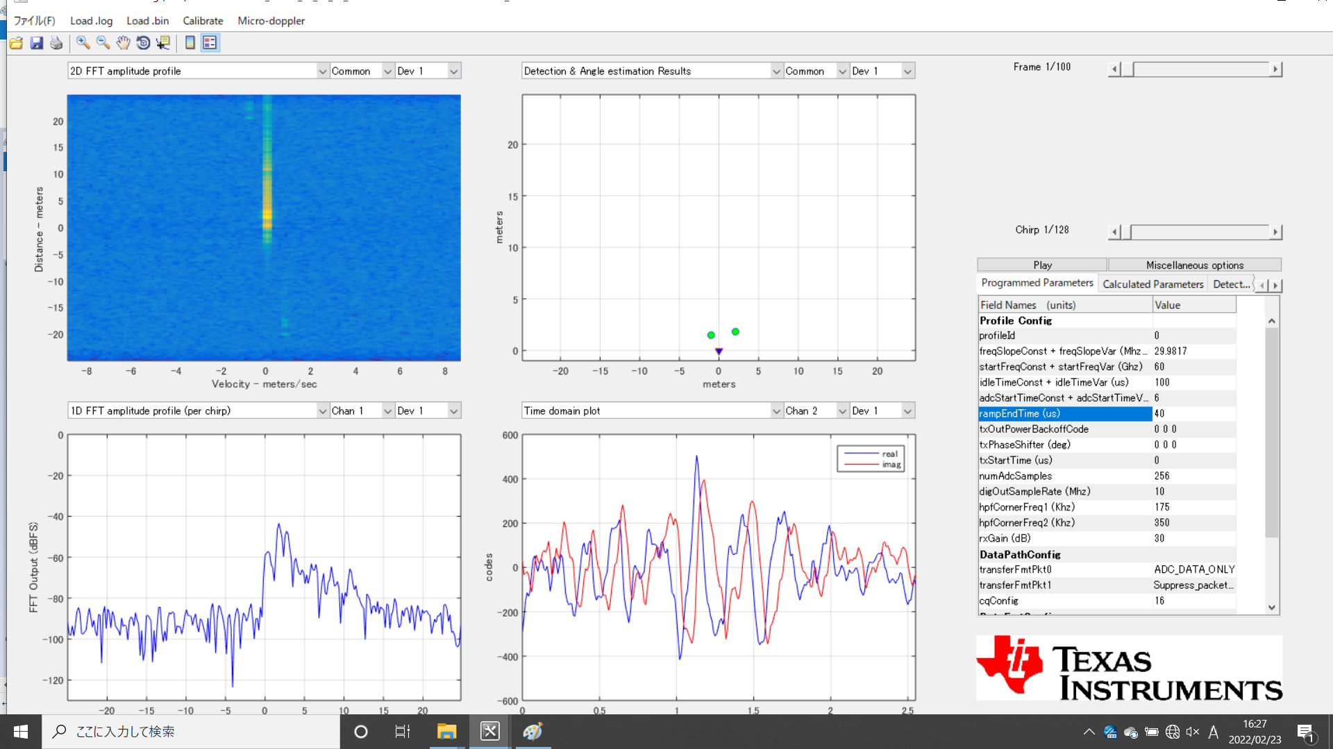

Though it is shown 40μsec and a change Ramp EndTime in Programmed Parameters when
I confirm the measurement log in PostProc, in Calculated Parameters, 0.7675GHz, RangResolution are not changed with 0.1953m BandWidth.
Please tell me the setting you want to drive RangResolution to 37.5mm (BandWidth is 4GHz).
