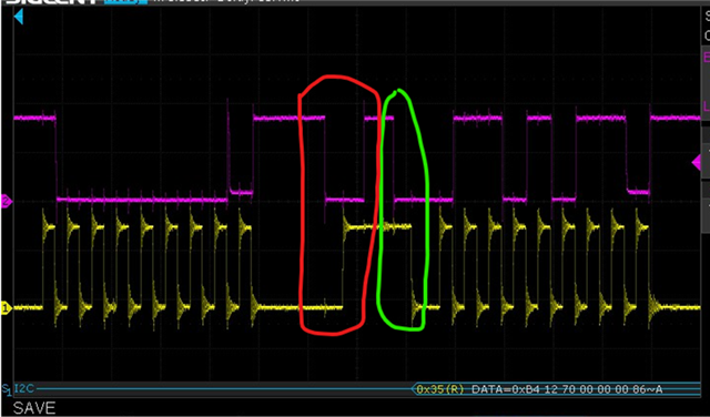

    That snapshot is very handy. I’ve had a close look at it and I saw a small difference in my oscilloscope image and your snapshot.

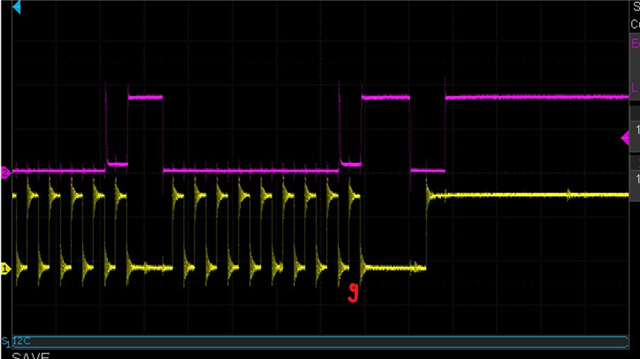

    My stop condition looks as follows: At the rising edge of the ninth clockcycle the ack bit gets clocked in and at the falling edge of the ninth clockcycle the TMAG5273 release the SDA line which makes it go to VCC (if the primary doesn’t take over pulling it low). If at that point you want to perform a stop condition you first have to pull the SDA line low, then release the clock and then release the SDA line once again.

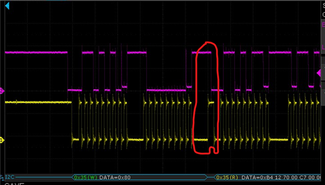

    In between the 0x80+ACK and the Read[0x35]+ACK I've implemented this stop condition and immediately after that a start condition which makes it look like this:
    Zoomed in with in redcircle the stop and in green circle the start:
    It seems like this one ‘extra’ flank on SDA makes the TMAG5273 start counting from zero again.
    Then it counts 7 bytes and at the 8th it inserts the CRC. (0x35R 0xB4 0x12 0x70 0x00 0x00 0x00 CRC)

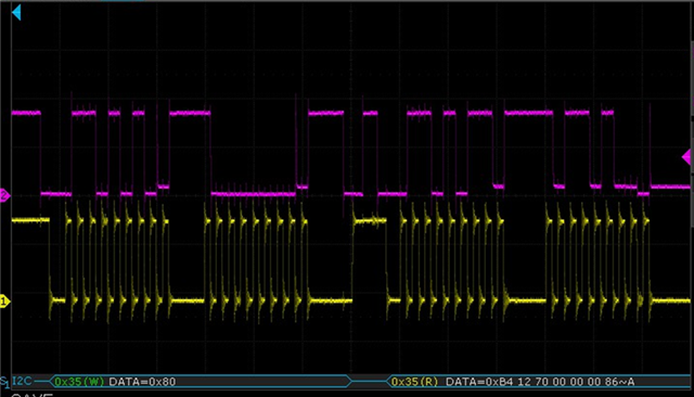

    Whereas if it starts counting from the beginning 7bytes, 8th CRC (0x35W 0x80 0x35R 0xB4 0x12 0x70 0x00 CRC)
    If instead of performing a stop- and start-condition I write a new ResetCondition function which leaves away this extra flank on SDA (like in your snapshot). Then I get the expected result :)
    Maybe this unexpected discovery is helpful for you guys to know as well because for me it saves the day.
