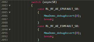

mmwDemo:/>Exception: ./mss/mss_main.c, line 2086.
 2086 line in mss_main.c is

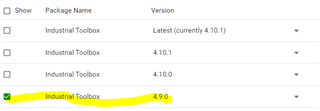

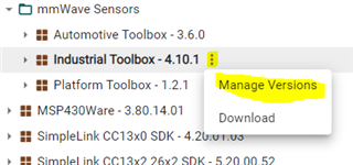

    You can download an older version of the toolbox by going to the toolbox online and selecting the three dots (highlighted below) and then selecting manage versions (highlighted below)
    Under manage versions selection version 4.9 (see below)

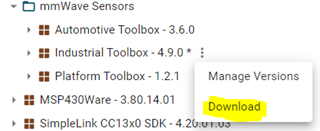

    Then select apply. You are now viewing version 4.9 of our toolbox. Select the three dots next to industrial toolbox and select download (see below).
    You are now ready to work with an older version of our toolbox where the out of box demo for 16xx works better. This version of the out of box demo for 16xx works with SDK 2.0.0.04. This can be found here under download options --> previous versions (see below).

    Load bin file from path(C:\ti\mmwave_sdk_02_00_00_04\packages\ti\demo\xwr16xx\mmw\xwr16xx_mmw_demo.bin) using uniflash but demo not run. there is an error.
    Check mss_main.c line 2102 and take it screenshot.
    there is a same problem as previous.
    this demo guide mention that "ES2.0 device only". so i check that difference form link("https://e2e.ti.com/support/sensors-group/sensors/f/sensors-forum/716263/iwr1642boost-es-2-0-label-where-is-this-label-found"). i check on my board IC. it is shows "XIWR1642 QG" , it mean that it is ES1.0 type device, so is this demo code compatible for this board?
