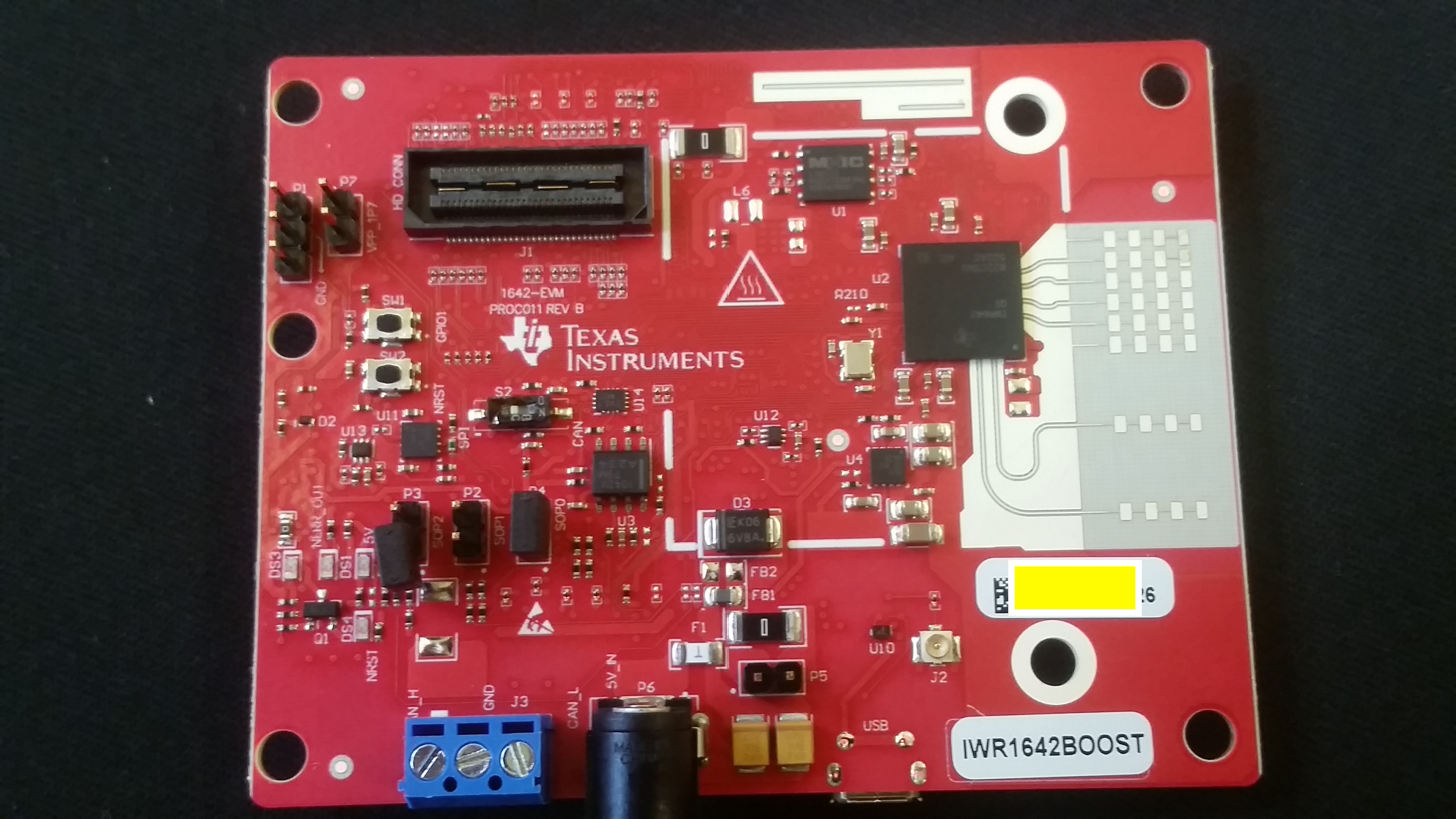

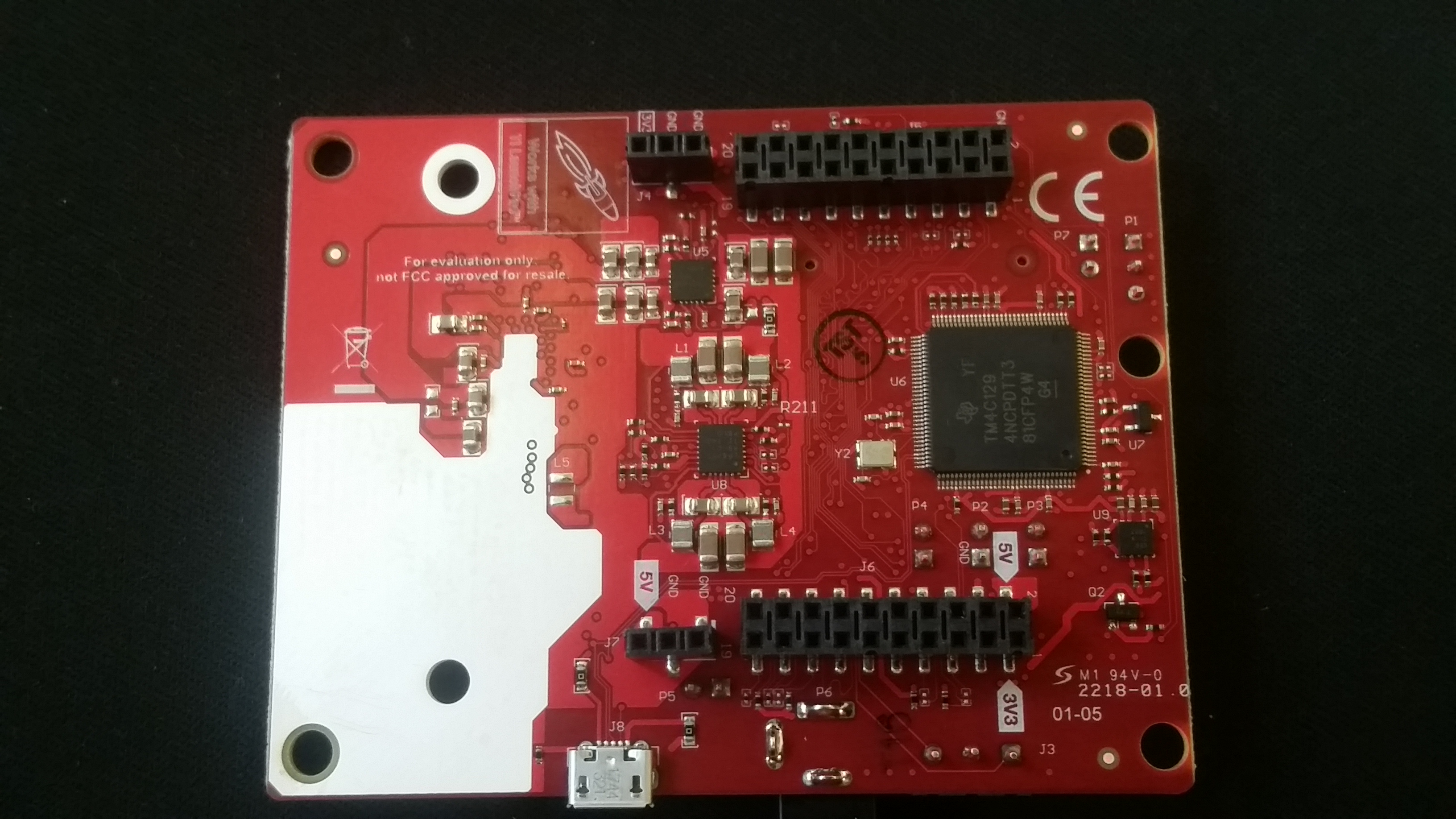

I would like to confirm that my device is either 1.0 or 2.0.   Because I do not see a ES 2.0 sticker this link:
https://e2e.ti.com/support/sensor/mmwave_sensors/f/1023/t/698870?-FAQ-IWR1642-IWR1642-ES2-0-is-here-find-applicable-software-based-on-Silicon-Rev
leads me to believe I do not have a 2.0 device.  The label on the box is data rich: it's hard to tell what's what when the data field is not labeled.   I am unable to find a good phone number for customer support to exchange the device.   Is there a good point of contact that can assist in expediting a ES 2.0 IWR1642BOOST?

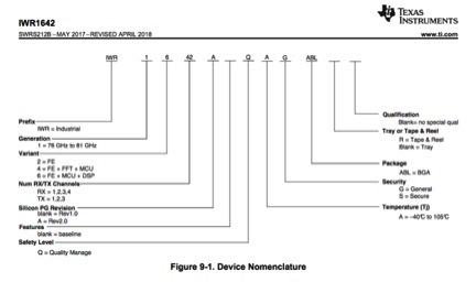

  • Raymond,
    Please refer to the "Device Nomenclature" of the IWR1642 datasheet that can be found here to determine which silicon revision you have:
    www.ti.com/.../iwr1642.pdf
    You will need to look on the actual packaging to determine this information.

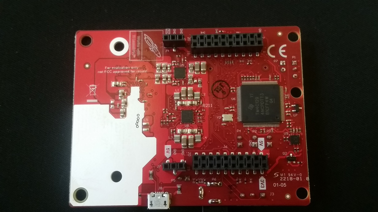

  • The IWR 1642 chip is labeled:
    IWR1642
    QG
    82ZC59
    502AC ABL G1
    The nomenclature convention per http://www.ti.com/lit/ds/symlink/iwr1642.pdf
    The IWR1642 chip does not have the 'A' suffix, which leads me to believe that the 'Silicon PG revision' is a 1.0.   I have not seen the definition of an ES 2.0 board-sticker (from a configuration management standpoint), though it would not surprise me if an 'ES 2.0' board requires a 2.0 IWR1642A chip.  If the Silicon PG Revision analysis is not correct, I would like to understand why.
    Is there an electronic litmus test (i.e. a test that can be performed with SDK 2.X)?
    "This lab will only work if the IWR1642BOOST EVM has a sticker that says "ES2.0". ES2.0 devices will only work with software based on mmWave SDK version 2.0 or above. If the EVM does not have the sticker, the device is ES1.0 and requires mmWave SDK version 1.xx.xx.xx. "
    I have requested to RMA the device, but before returning it: I think it makes sense to confirm that the EVM is a 'ES 1.0' EVM board.
    I would like to understand the definition of an 'ES 2.0' stickered EVM board and how it is fundamentally different from the unlabeled 'ES 1.0' EVM Board

  • I had specifically requested a ES2.0 device from the TI store and was shipped a device that was not labeled ES2.0 (forums indicate that lack of such a label is 1.0 device). At $300 for the EVM, I expect to be able to use the latest people counting demo software and not be relegated to older versions. The questions are centered around how to definitively confirm the whether device is a 1.0 or 2.0 **EVM board**. If it is a 2.0 board and just not labeled, I can accept that if I can confirm 2.0 functionality with a 'litmus test'.
    Akashi Gondola indicated:
    If it [1642 Chips] says 502 then it is ES1.0, and if it says 502A then it is ES2.0.

  • Kyle,
    I appreciate your patience and explanations. I do not have a devPack or DCA1000: I purchased the only the EVM1642BOOST from the TI store.   I am seeking to avoid configuration management issues by using only 2.0 hardware.
    Based on your response, the takeaway is that an ES2.0 label applies not only to the board: it also applies to the version of the radar chip, which is also supported by TI's Akash Gondola:
    If it [1642 radar chip] says 502 then it is ES1.0, and if it says 502A then it is ES2.0.
    @community:
    This new bit of information indicates that my device MAY be 2.0. I now seek a procedure that comprises connecting the EVM device to a PC and perform a test that will confirm 2.0 hardware \ functionality.
    Raymond

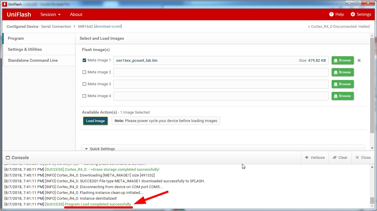

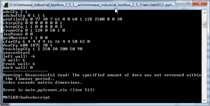

  •  A windows 7 PC is configured with:
    • mmwave industrial toolbox 2.5.1 (requires ES2.0 IWR1642BOOST)
    • Uniflash 4.4.0
    • mmwave_SDK 02_00_00_04
    Step 3 of this the people counter procedure to flash the EVM was successful.
    dev.ti.com/.../pplcount_user_guide.html

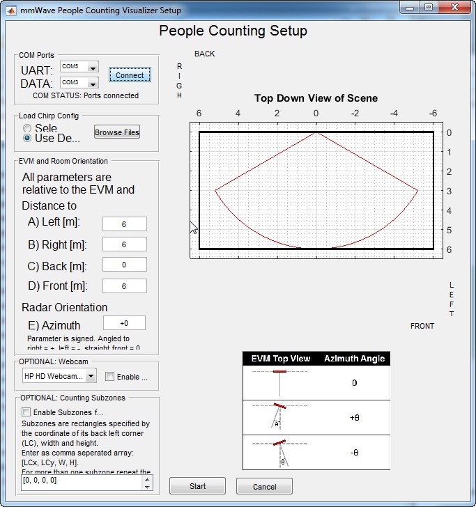

    Starting the application causes a crash:
    Is it possible to conclude the EVM is a 2.0 device despite the error message above?
    Is there a simpler procedure (link is appreciated) that can verify that the device is ES 2.0?
    Raymond
  • Raymond,
    I would suggest starting with our out-of-box demo.
    This can be at this location on your computer: C:\ti\mmwave_sdk_02_00_00_04\packages\ti\demo\xwr16xx\mmw
    Use the Uniflash tool to flash the binary file.
    Then use the online visualizer found here: dev.ti.com/.../
    Please make sure to read the documentation for both the out-of-box demo and the online visualizer to understand how to use them.
