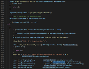

  • Hello Justin,
    You can see in the following code snip from objectdetect.c, that the heatmap is generated after the DSP rangeProc function and before the doppler processing.
    It seems the parsing (although it isn't fully a parser) in the linked thread above should be similar, but there may have been subtle data format changes since that post. I suggest you try it and see if the data lines up.
    Jackson
