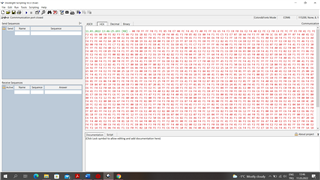

I tried to understand datas which sends from AWR1843BOOST. I watched the UART line with Dochlight Scripting program and I got some ununderstandable datas like this.

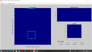

Then I set it as Getting Started Guide and watched on GUI.
I tried to watch on both GUI and  Dochlight Scripting at the same time but of course UART line doesnt allow it. Then I closed the GUI screen and watch on  Dochlight Scripting again. I saw that the data again.
As far as I understand from your posts, it must first be sending the data "0x0102, 0x0304,0x0506,0x0708" called magic_word. Then, data such as version, totalPacketLen, platform should be reached. However, I have never come across magic_word in the UART line that I examined. I want to make sense of this data before reading it with python. I'm new to coding, so I want to first see and understand the data packets sent with the Dochlight Scripting application.

    If I understand correctly you are trying to understand the UART data sent by the MRR demo.
    One way to understand it is to see the matlab gui parsing code
    labs\lab0007_medium_range_radar\gui\MRRvisualization\read_serial_port_and_plot_object_location.m
    See barker_code detection - lines 151.
