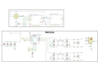

    • Can you send a schematic of your sensor setup?

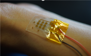

  • Here's our sensor and the boards' schematic. We use a bluetooth chip for data communication.
    For the setup, we put our sensor on wrist to measure the pulse (Capacitance variance) and the sensor is connected to the board.
    Thanks for helping!
  • Hi Patrick,
    Based on the information you provided, I feel like the issue might be due to EMI.

    Can you post a picture of the electrodes that connect to the skin so we can get a better idea of your sensor?
  • I see. We use micro USB for the sensor side to board and Use a double layer board design to have bigger spaces for each component to reduce the EMI effects. Is there any suggestions?
    We use Iontronic materials for the dielectric so the capacitance will easy be changed from pf to nf.
    The picture is on the previous reply. Thanks!
