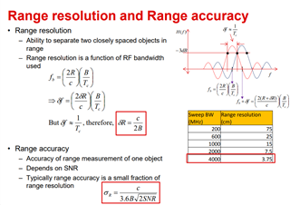

Hi Kukhokuhle,
I'm glad you were able to find the answer, here is some more documentation I found.
Thank you,
Angie
