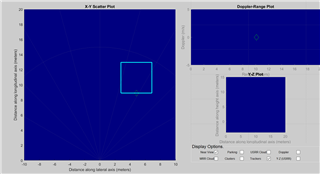

Following the Tracker output generated by UI in a still indoor room.
According the UI the cluster size is approximately 4m wide and 4m length (from the figure the square is the cluster detected by the sensor)

According to the parsed log generated the type 3 tlv Cluster Size is xSize and ySize is around 261 .
How is it related to the information in GUI? I was expecting some values related to 4m in parsed information. Also is the value 261 in cm ? Where can I get more details about it?

  • This log is captured as original raw data from UART interface as it is sent from MRR aplication.
    But the visualizer plot does some of the basic calculation while it is plotting on the screen, please refer the visualizer source code from the MRR package for more info.
    labs\lab0007_medium_range_radar\gui\MRRvisualization
    And you can refer MediumRangeRadar_DeveloperGuide.pdf for TLV data format info.

  •  Hi ,
    I understand visualizer is doing some calculation, I am looking for exactly what is doing by the visualizer. Could you please share me more details on what is happening under the hood.
    According to my understanding,
    • from the raw data log from UART , TLV "data"  needs to be divided by 2^ 7 , where 7 is xyzQFormat specifed for the TLVs.
    • According to this, xSize and ySize will be 2.03 (= 261/128) But in the GUI it is around 4m lengtth and 4m width
    • I'm asking for this data mismatch , Is there any other calculation I'm missing. Please guide me
  • Hi Asha,
    Object type is MMWDEMO_OUTPUT_MSG_TRACKED_OBJECTS (3) in above parsed data.
    If you follow dss_main.c file
    this data maps to trackerOpFinal
    which is this structure
    typedef struct trackingReportForTx_t
    int16_t x; /**< the tracking output -> x co-ordinate */
    int16_t y; /**< the tracking output -> y co-ordinate */
    int16_t xd; /**< velocity in the x direction */
    int16_t yd; /**< velocity in the y direction */
    int16_t xSize; /**< cluster size (x direction). */
    int16_t ySize; /**< cluster size (y direction). */
    } trackingReportForTx;
    So xSize and ySize if cluster size. not the Plot's max X & Y size.
