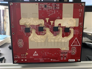

(1) Here is my test setup. The strong corner reflector was higher than the radar.

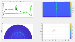

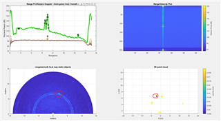

(2) I used the TI default given code below for processing the raw data.
C:\ti\mmwave_studio_03_00_00_14\mmWaveStudio\MatlabExamples\4chip_cascade_MIMO_example
From above, I can see that the range-azimuth heatmap is consistent with the setup scene. The point cloud plot somehow is right-left flipped?
Other than that from my test, the radar forward is +Y, to right is +X, up is +Z

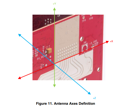

However, the frame definition of "AWRx Cascaded Radar RF Evaluation Module.pdf" was given as below, which is absolute different.
My question are that
(1) Where is the origin point located on the RF board when the raw data was processed with the given code, namely 4chip_cascade_MIMO_example?
     Is there any reference figures on how those 3D points were calculated?
(2) If the origin point is the same with Figure 11 above, how Figure 11 was related to the frame that being used for 4chip_cascade_MIMO_example?

     1) The interpretation of x,y and z is arbitrary in comparison to figure and plot. Yes, the point cloud is flipped in the x axis comparing to the heatmap.
    2) What I meant was ideally it really doesn't matter where you keep the origin. Ultimately you are going to calibrate the TX's and RX's at far distance object in controlled environment. The origin was not chosen randomly it has to be aligned with your antenna patches. But at the same time figure 11 talks about origin kept at block A, doesn't mandate that you also keep the same, you can keep the origin at block B too, but you have to ensure you calibrate out all TX and RX antennas for phase.
    There is no relation of frame data and origin.
