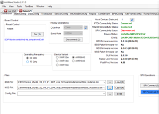

Hello Team,
I have IWR6843AOPEVM with mounted on mmwaveboost and also connect with DCA1000 for raw data capture. I have few problems in regards this. First one is the connection between DCA1000 and mmwaveboost for 6843AOP. Other one to collect raw data but saves in form of CSV file. Can you help me in this regard Please?
Thank yoy

  • Thank you for your kind reply. Following are the outputs from Mmwave studio when I click on Sp1 Connect and also it cannot show me the device status as I'm using IWR6843AOPEVM.
    Please help me in this regard. And also How I can capture raw data when I'm using vital sign demo Gui.

    [15:27:07] [RadarAPI]: ar1.selectRadarMode(0)
    [15:27:07] [RadarAPI]: Status: Passed
    [15:27:07] Matlab Runtime Engine is installed
    [15:27:07] [RadarAPI]: Starting Matlab Engine..
    [15:27:25] [RadarAPI]: Matlab Engine Started!
    [15:27:30] [RadarAPI]: ar1.selectCascadeMode(0)
    [15:27:30] [RadarAPI]: Status: Passed
    [15:27:30] [RadarAPI]: ar1.LoadSettings('C:\Users\2332489A\AppData\Roaming\RSTD\ar1gui.ini')
    [15:27:31] TESTING = false
    [15:27:31] RstdNet: Port 2777: Listening..
    [15:27:31]
    [15:27:31] ***Script completed successfully.***
    [15:28:17] [RadarAPI]: Opening Gpio Control Port()
    [15:28:17] [RadarAPI]: Status: Passed
    [15:28:18] [RadarAPI]: Opening Board Control Port()
    [15:28:18] [RadarAPI]: Status: Passed
    [15:28:19] [RadarAPI]: ar1.FullReset()
    [15:28:19] [RadarAPI]: Status: Passed
    [15:28:20] [RadarAPI]: Closing Board Control Port()
    [15:28:20] [RadarAPI]: Status: Passed
    [15:28:20] [RadarAPI]: Closing Gpio Control Port()
    [15:28:20] [RadarAPI]: ar1.SOPControl(2)
    [15:28:45] [RadarAPI]: ar1.Connect(6,115200,1000)
    [15:28:48] [RadarAPI]: Error: Connection failed: Calling_ConnectTarget returned 3
    [15:28:48] [RadarAPI]: ar1.Calling_IsConnected()
    [15:28:48] [RadarAPI]: ar1.SaveSettings('C:\Users\2332489A\AppData\Roaming\RSTD\ar1gui.ini')
    [15:29:16] [RadarAPI]: ar1.frequencyBandSelection("60G")
    [15:29:19] [RadarAPI]: ar1.Connect(6,115200,1000)
    [15:29:21] [RadarAPI]: Error: Connection failed: Calling_ConnectTarget returned 3
    [15:29:21] [RadarAPI]: ar1.Calling_IsConnected()
    [15:29:21] [RadarAPI]: ar1.SaveSettings('C:\Users\2332489A\AppData\Roaming\RSTD\ar1gui.ini')
    [15:30:00] [RadarAPI]: ar1.Connect(6,115200,1000)
    [15:30:02] [RadarAPI]: Error: Connection failed: Calling_ConnectTarget returned 3
    [15:30:02] [RadarAPI]: ar1.Calling_IsConnected()
    [15:30:02] [RadarAPI]: ar1.SaveSettings('C:\Users\2332489A\AppData\Roaming\RSTD\ar1gui.ini')
    [15:30:38] [RadarAPI]: Opening Gpio Control Port()
    [15:30:38] [RadarAPI]: Status: Passed
    [15:30:39] [RadarAPI]: Opening Board Control Port()
    [15:30:39] [RadarAPI]: Status: Passed
    [15:30:40] [RadarAPI]: ar1.FullReset()
    [15:30:40] [RadarAPI]: Status: Passed
    [15:30:40] [RadarAPI]: Closing Board Control Port()
    [15:30:41] [RadarAPI]: Closing Gpio Control Port()
    [15:30:41] [RadarAPI]: Status: Passed
    [15:30:41] [RadarAPI]: ar1.SOPControl(2)
    [15:30:42] [RadarAPI]: ar1.Connect(6,115200,1000)
    [15:30:44] [RadarAPI]: Error: Connection failed: Calling_ConnectTarget returned 3
    [15:30:44] [RadarAPI]: ar1.Calling_IsConnected()
    [15:30:44] [RadarAPI]: ar1.SaveSettings('C:\Users\2332489A\AppData\Roaming\RSTD\ar1gui.ini')
    [15:32:28] [RadarAPI]: Opening Gpio Control Port()
    [15:32:28] Status: Failed to open/close GpioControl, Error Type: PROTOCOL ERROR
    [15:32:29] [RadarAPI]: Opening Board Control Port()
    [15:32:29] [RadarAPI]: Status: Failed to open/close BoardControl, Error value: -1
    [15:32:30] [RadarAPI]: ar1.FullReset()
    [15:32:30] [RadarAPI]: Status: Failed To give full reset, Error Value: -7
    [15:32:30] [RadarAPI]: ar1.SOPControl(2)
    [15:32:30] [RadarAPI]: Status: Passed
    [15:32:38] [RadarAPI]: ar1.Connect(6,115200,1000)
    [15:32:41] [RadarAPI]: Error: Connection failed: Calling_ConnectTarget returned 3
    [15:32:41] [RadarAPI]: ar1.Calling_IsConnected()
    [15:32:41] [RadarAPI]: ar1.SaveSettings('C:\Users\2332489A\AppData\Roaming\RSTD\ar1gui.ini')
    [15:32:43] [RadarAPI]: Opening Gpio Control Port()
    [15:32:43] [RadarAPI]: Status: Passed
    [15:32:44] [RadarAPI]: Opening Board Control Port()
    [15:32:44] [RadarAPI]: Status: Passed
    [15:32:45] [RadarAPI]: ar1.FullReset()
    [15:32:45] [RadarAPI]: Status: Passed
    [15:32:45] [RadarAPI]: Closing Board Control Port()
    [15:32:45] [RadarAPI]: Closing Gpio Control Port()
    [15:32:45] [RadarAPI]: ar1.SOPControl(2)
    [15:32:46] [RadarAPI]: Status: Passed
    [15:32:49] [RadarAPI]: ar1.Connect(6,115200,1000)
    [15:32:51] [RadarAPI]: Error: Connection failed: Calling_ConnectTarget returned 3
    [15:32:51] [RadarAPI]: ar1.Calling_IsConnected()
    [15:32:51] [RadarAPI]: ar1.SaveSettings('C:\Users\2332489A\AppData\Roaming\RSTD\ar1gui.ini')
    [15:38:44] [RadarAPI]: Opening Gpio Control Port()
    [15:38:44] Status: Failed to open/close GpioControl, Error Type: PROTOCOL ERROR
    [15:38:45] [RadarAPI]: Opening Board Control Port()
    [15:38:45] [RadarAPI]: Status: Failed to open/close BoardControl, Error value: -1
    [15:38:46] [RadarAPI]: ar1.FullReset()
    [15:38:46] [RadarAPI]: Status: Failed To give full reset, Error Value: -7
    [15:38:46] [RadarAPI]: ar1.SOPControl(2)
    [15:38:46] [RadarAPI]: Status: Passed
    [15:38:48] [RadarAPI]: Opening Gpio Control Port()
    [15:38:48] Status: Failed to open/close GpioControl, Error Type: PROTOCOL ERROR
    [15:38:49] [RadarAPI]: Opening Board Control Port()
    [15:38:49] [RadarAPI]: Status: Passed
    [15:38:50] [RadarAPI]: ar1.FullReset()
    [15:38:50] [RadarAPI]: Status: Passed
    [15:38:50] [RadarAPI]: Closing Board Control Port()
    [15:38:50] [RadarAPI]: ar1.SOPControl(2)
    [15:38:52] [RadarAPI]: Opening Gpio Control Port()
    [15:38:52] Status: Failed to open/close GpioControl, Error Type: PROTOCOL ERROR
    [15:38:52] [RadarAPI]: Opening Board Control Port()
    [15:38:52] [RadarAPI]: Status: Failed to open/close BoardControl, Error value: -1
    [15:38:53] [RadarAPI]: ar1.FullReset()
    [15:38:53] [RadarAPI]: Status: Failed To give full reset, Error Value: -7
    [15:38:54] [RadarAPI]: ar1.SOPControl(2)
    [15:38:54] [RadarAPI]: Status: Passed
    [15:38:56] [RadarAPI]: Opening Gpio Control Port()
    [15:38:56] [RadarAPI]: Status: Passed
    [15:38:57] [RadarAPI]: Opening Board Control Port()
    [15:38:57] [RadarAPI]: Status: Passed
    [15:38:58] [RadarAPI]: ar1.FullReset()
    [15:38:58] [RadarAPI]: Status: Passed
    [15:38:58] [RadarAPI]: Closing Board Control Port()
    [15:38:58] [RadarAPI]: Closing Gpio Control Port()
    [15:38:58] [RadarAPI]: ar1.SOPControl(2)
    [15:39:00] [RadarAPI]: Opening Gpio Control Port()
    [15:39:00] [RadarAPI]: Status: Passed
    [15:39:01] [RadarAPI]: Opening Board Control Port()
    [15:39:01] [RadarAPI]: Status: Passed
    [15:39:02] [RadarAPI]: ar1.FullReset()
    [15:39:02] [RadarAPI]: Status: Passed
    [15:39:03] [RadarAPI]: Closing Board Control Port()
    [15:39:03] [RadarAPI]: Status: Passed
    [15:39:03] [RadarAPI]: Closing Gpio Control Port()
    [15:39:03] [RadarAPI]: ar1.SOPControl(2)
    [15:39:04] [RadarAPI]: ar1.Connect(6,115200,1000)
    [15:39:05] [RadarAPI]: ar1.Calling_IsConnected()
    [15:39:06] Device Status : UnDetDe/QM/SOP:2/ES:2
    [15:39:06] [RadarAPI]: ar1.SaveSettings('C:\Users\2332489A\AppData\Roaming\RSTD\ar1gui.ini')
    [15:40:04] [RadarAPI]: ar1.DownloadBSSFw("C:\\ti\\mmwave_studio_02_01_01_00\\rf_eval_firmware\\radarss\\xwr68xx_radarss.bin")
    [15:40:04] [RadarAPI]: Downloading BSS ROM RPRC Binary..
    [15:40:52] [RadarAPI]: ar1.GetBSSFwVersion()
    [15:40:52] [RadarAPI]: BSSFwVersion:(06.01.01.00 (08/04/19))
    [15:46:28] [RadarAPI]: ar1.DownloadMSSFw("C:\\ti\\mmwave_studio_02_01_01_00\\rf_eval_firmware\\masterss\\xwr68xx_masterss.bin")
    [15:46:28] [RadarAPI]: Downloading MSS RPRC Binary..
    [15:46:47] [RadarAPI]: ar1.GetMSSFwVersion()
    [15:46:47] [RadarAPI]: MSSFwVersion:(02.00.00.03 (27/08/19))
    [15:48:57] [RadarAPI]: ar1.PowerOn(0, 1000, 0, 0)
    [15:48:57] Status: Failed, Error Type: RESP TIMEOUT
    [15:49:01] MSS Power Up async event was not received!
    [15:49:50] [RadarAPI]: ar1.PowerOn(0, 1000, 0, 0)
    [15:49:50] Status: Failed, Error Type: RESP TIMEOUT
    [15:49:54] MSS Power Up async event was not received!

  • Can you try mmwave studio version 2.1.0. This is the version I use.
    Additionally, is this problem replicable every time? This thread suggests resetting the device before operation, which seems to have worked for them.
    https://e2e.ti.com/support/sensors-group/sensors/f/sensors-forum/744606/awr1243boost-spi-connect-resp-timeout-issue-in-mmwave-studio-with-a-dca1000evm
    Nate
  • Thank you nathan for your help. I have mmwave_studio_02_01_01_00 this version. But I think you cannot understand my question.
    Actually when I connect both devices it work well I can capture the bin file but the problem here is that after starting the gui of Vital sign it cannot started and give me the error as mentioned earlier. So how I can collect vital sign raw data.
    Fahad
