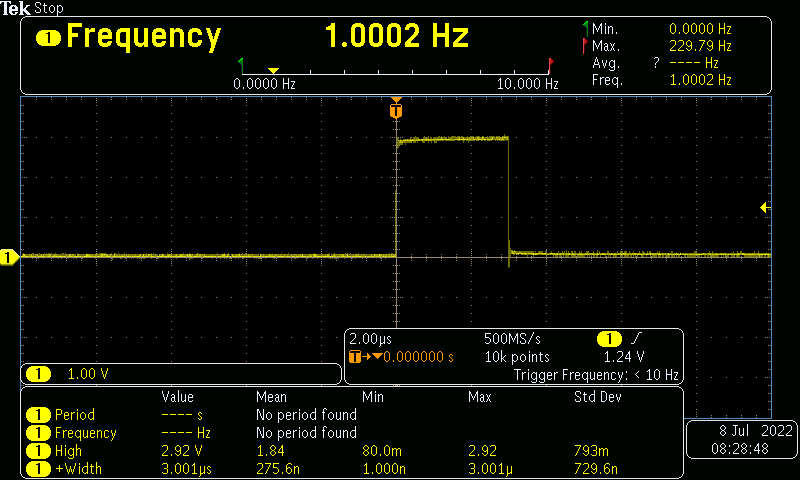

    Here are some screenshots of signals which were captured on my hardware.
    I tried to trigger TDC1000 every second, below screenshot is signal from TRIGGER pin (Without TX transducer connected)
    I also config TDC1000 transmit 5 pulses per measurement and below are signals from STOP pin (STOP_OUT test point P0301 on my above schematic)
    And the signals below are from COMPIN (Test point TP0304 - COMPIN_OUT on my above schematic)

  • Hello Trieu,
    Thanks for the scope captures, I was hoping to get a capture of both the START pulse and COMPIN or STOP in a single capture to get a better timing reference. But if the distance of your other transducer is .5m and the speed of sound in room temp water is ~1480m/s we can calculate your expected with this formula ToF = .5m/1480m/s, your expected time of flight should be ~337us.
    The device needs to be configured properly in order to listen at the appropriate time. My main thought is that as of now it is currently listening very early in the measurement. In order to configure the TDC1000 we can do this by configuring the TIMING_REG appropriately.
    If you could provide your device configuration and register settings I can help you figure out if your echo listening window configuration is ideal for your test setup.
