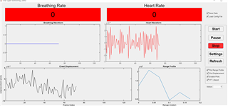

We have an IWR1443BOOST mm-wave radar sensor.
We were collecting data using this radar sensor with Vital Sign Demo Software.
In our notion, there should not be any peak in the Range Profile plot, when there is no person in front of the radar. But to our surprise, we were getting peaks in the Range profile even if there is no one in front of the radar (please refer to the attached figure).
Our query is that is this behavior of the radar okay or not okay?
Moreover, if some corrections are required, then what is the process to do it?
Kindly suggest and help us.
Thanking you
Amit

    What objects may be in front of the radar when you are seeing this data?

  • Hi Angie,
    Thanks for the reply.
    Please note that this experiment was done in an anechoic chamber.
    The radar was placed on a carpet on the floor and there was no object kept in front of it.
    Still, we were getting peaks, which should not happen theoretically.
    If we see carefully the figure attached, it is showing that there is an object within a distance of 0.1 m.
    But, practically there was no object placed in front of the radar.
    So, our query is how to correct this unusual behavior of the radar?

  • Hi Amit,
    What you are seeing is TX/RX coupling, this is seen in all devices. The coupling has become more apparent because you are in an anechoic chamber.
