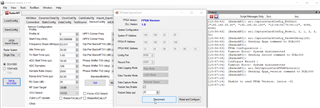

  • Hi Cesar,
    I am back again after successfully re-flashing the FPGA. However, this problem still persists. I am still having issues with communication with the FPGA. I included a few screenshots below to describe what I am seeing.
    1 - Error messages when I hit "Reset and Configure" after entering "Set up DCA1000" option under SensorConfig in mmWave Studio:
    2 - Error messages when I hit "Disconnect" after entering "Set up DCA1000" option under SensorConfig in mmWave Studio:
    3 - Error messages when I try to configure the boards using lua script in mmWave Studio:
    Please note I have a second identical DCA1000EVM hardware setup with the same radar board that works perfectly using the same lua script.
    Can you please help explain what seems to go wrong here? Any suggestions on how to resolve this matter?
    Cagri
  • I am not sure if anybody is reading my threads here at all since I received zero response to them so far (maybe it is because this thread is stale and obsolete). However, I will continue writing and eventually open a new thread by copying and pasting all the information here for others to notice Slight smile
    I tried the same radar hardware set up on another computer and the FPGA configuration worked perfectly as expected ! I also went ahead and successfully captured a few raw ADC samples to confirm everything works. I was able to view the post-processed raw ADC samples as well and all seems to be in order.
    The above at least confirms the hardware is in good working order and all the switch and SW configurations I have are as they should be. I am also using the same mmWave Studio versions on both computers so that is not the issue either. This indicates the two computers are not behaving the same for some reason.
    I initially suspected that the Ethernet controller may not be working properly so I used two different external USB based ethernet controllers and tried to configure the FPGA with those. However, the same problem persists; I still cannot read the FPGA version still.
    Given the above information, do you have any suggestions on what I should look at next? Where is the issue likely to be?

  • Thanks for the reply Cesar.
    The two computers have the same OS (Windows 10). I have already read the Debug Handbook while troubleshooting this problem over the last few days.
    Given the information above, can you conclusively confirm that this issue is related to Ethernet communication with the board and nothing else? Though the two computers are managed by the same IT team, there may be a few not so obvious differences that may be causing this issue. Therefore, if you can confirm that Ethernet connection is the issue, I can then pay them a visit to sort this out in person. (I cannot modify some of my computer settings due to IT policies unfortunately)
    Thanks for your help.
    Cagri
  • First, make sure that the ethernet cables are the same in both tests.
    In the DCA1000 config, can you try to increase the packet delay to 300.
    There could be a difference in the Ethernet HW for the two PCs
    thank you
    Cesar
