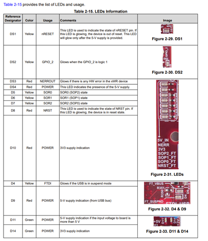

Is it correct, that the LEDs close to SOP jumpers have different intesities?
When measuring the voltage I observe:
5V In -> 5.19 V
NEVR -> 3.27 V
3V3 -> 3.27 V
SOPx -> 1.8 V When the jumper is closed
NRST -> 1.71 V
(All measured before the resistors)
The following page mentions when NRST glows the device is in reset state.
It is continuously glowing until NRST button is pressed.
What ist he difference compared to DS1? Since they behave equally

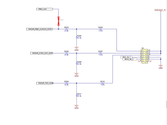

    We measured the voltage level at C21 to obtain the V_IOIN pin voltage and measured 3.3V.
    Regarding the following information:
    We concluded to have 3.3V logic.
    The SOP0 jumper at the MMWAVEICBOOST is closed and S1.3 is OFF.
    Subsequently we measured the voltage level at R209 to get the voltage level of SOP pin an measured 1.71 Volts
    Compared to your design, is that compliant?
    With expected to measure something around 2.7V.

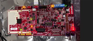

  • Hi Adrian,
    According to our customer,
    I received the hardware from my colleague and tried to flash his hardware.
    It works very sporadically for me, most of the time I see the error as shown in picture 1.
    However, sometimes when the tool is able to erase the flash as shown in picture 2 it works.
    But the latter case is very rare.
    Do you have any idea what causes the problem?
    I tried it on two different PCs running (Windows 10 and 11)
    Both show the same behaviour
    Danilo
