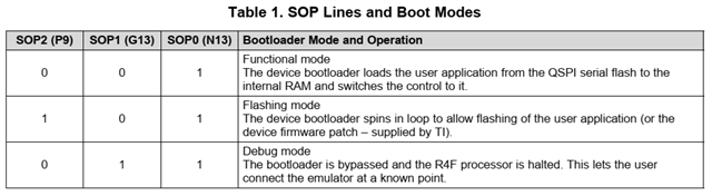

  • We DO NOT have an EEPROM populated on our board. Our production IWR firmware is loaded over SPI into RAM on each boot.
  • I've fixed the SOP lines to 011 as described in the IWR6843 Bootloader Flow

After doing some research on this forum and elsewhere it appears this error comes up often and doesn't point to the root cause at all. Two fixes are often mentioned:
  1. Set the SOP pins correctly (I think I have).
  2. Set the image to "development" mode in either CCS or Uniflash.
    1. We don't use Uniflash because we load the image into RAM over serial.
    2. I can't find ANY mention of "development mode" in CCS or the utilities that assemble the image (out2rprc and MulticoreImageGen)
    3. There is no image.syscfg generated when I import the mmwave demo into CCS.
