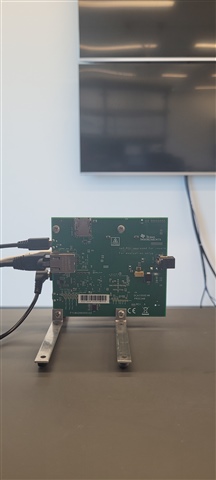

  • Hi Vivek,
    Thanks for your guidance. See information received from Cx:
    I am trying to be sure that the radar board captures the scene correctly.Please attached images where I triggered a frame to capture a scene.The radar board is faced to the wall which is 2 meters away from the radar.As can be seen from the Matlab plots, the range-angle plot shows a weird image which doesn't correspond to the scene captured.
    So I am trying to be sure that if the AWR1243 board needs calibration.
    Thank you.
    Archie A.
    I see that the sensor is showing multiple static objects, including the 2m wall in front. Why do they this it does not correspond to the scene?
    Vivek
  • Hi Vivek,
    Cx responded:
    When you look at the range-angle plot, radar is supposed to only see the wall which is 1.5-2m away from radar.
    On the range-angle plot, there are many yellow spots on the plot which are beyond 2m.
    Though we expect the radar to see only the wall.
    Because there are no other objects in sight of radar.
    The question arises about if the radar is well tuned/calibrated.
    We have doubts that the radar is not working as it is supposed to.
    Thank you.
    Archie A.
  • Hello Archie,
    Radar is capable of penetrating  walls and the objects beyond 2m in front could be objects present on the other side of the wall. It could also by "double reflections" caused by wall it has a very reflective material. In that case the the further objects would be exactly twice the distance of the wall.
    There are no issues with calibration that can cause this.
    regards,
    vivek

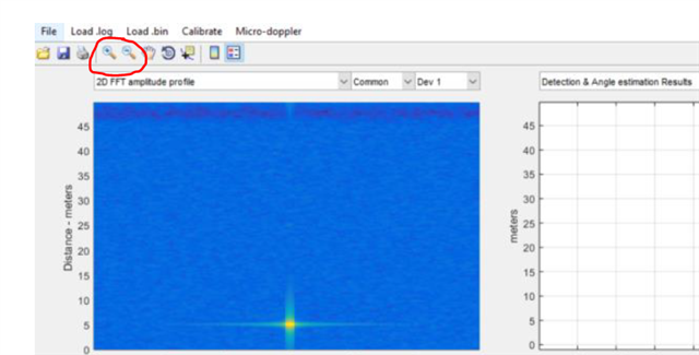

  • Hello Archie,
    The post processing the ADC data is done in Matlab. But the source code is not available.
    You can restrict the axis in the plot , keep the range to 2m.
    regards,
    Vivek
  • Thanks, Vivek.
    How can we change the range of the plot to 2m? Or is there any zoom tool on the plot?
    Archie A.

  • Hello Archie,
    You can find the zoom tool in the plot , shown below (in red circle.
    Vivek
