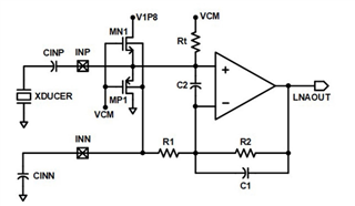

    Thanks for the clarification, I am not sure what the input stage of the PGA460-Q1 is exactly, but typically the first stages may look something like the image below. Where the MN1 and MP1 FETs provide protection to the device in case of high voltages, the device must be able to protect itself in the scenario that higher voltages make it through into the input stage while the CINP capacitor provides protection by limiting the current that makes it into these pins.
    This could be what is causing some of the distortion in your signal. But perhaps increasing RINP to a higher resistor could help you yield better results as I mentioned placing an external LNA is new territory for us when it comes to PGA460 so this is not something we have really tested on our side.

    By the way, in your figure, is VCM 0.9 V? Is this what has been generated elsewhere from 1.8 V?
  • Hello Satoshi-san,
    The VCM is not always 0.9V, it is dependent on the INP and INN inputs. So it is being generated elsewhere from the 1.8V.
    Isaac
  • Thank you for the answer. I'm still not sure about VCM so let me clarify. In an ideal situation, VCM is not supposed to fluctuate, am I correct? Or is the fluctuation necessary to detect and amplify the signal (that is, for the LNA to do its job)?
    That is correct in an ideal situation the VCM is not supposed to fluctuate, this fluctuation should have been removed by the DC blocking cap at the input. Regardless in the image referenced above the VCM is not part of the LNA amplification circuit. Which means the LNA would simply amplify what it is given. The only items looking at the fluctuations are the FETs.
    Just as a reminder this might not be the input PGA460-Q1 and is simply a reference to what LNA could look like for ultrasonic AFEs. There are other topologies that could be used.
    Isaac

  • Sorry, back again to the LNA internal circuit you presented, are the symbols (arrow directions) for MN1 & MP1 (these are NMOS & PMOS, respectively, I guess) typo? Or the names ("MN1" & "MP1") typo? Or are they all correct? I guess the former, but I can't be sure.
    Sorry for the delay I was not able to review your question last week. I will review this tomorrow and get back to you with a response!
    Isaac
    They are an NMOS and a PMOS, not sure why the MN1 and MP1 naming scheme was chosen for this image. I suppose they thought it was easier to understand but it just indicates MOSFET N and MOSFET P. To answer your question, the images are correct.
    Isaac
  • Thanks. I figured there seemed to be several conventions to the MOSFET symbols, including the arrow direction.
