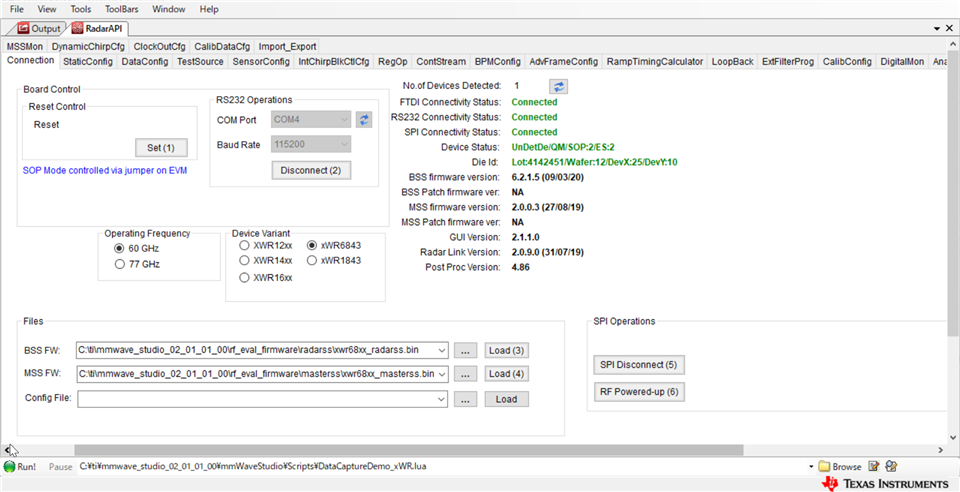

  • Hi, Nafisi-san, thank you for your reply. I took several snapshots of PC/HW settings. Please take a look.
    static IP setting:
    WiFi disable setting:
    Firewall off setting:
    Sorry, all above settings is displayed in my local language : Japanese, but you can see Firewall is set off by the location of the radio button.
    IWR6843AOPEVM+MMWAVEICBOOST+DCA1000EVM settings:
    FFPGA 'done' LED of DCA1000 glows.
    mdevice manager status:
    mmWave Studio connection tab:
    mmWave Studio "Setup DCA1000" window:
    In this window, FPGA version doesn't change when pressing "Connect, Rest and ..." button. and there is no error message in the output window.

  • Hello Morishita-san
    Thank you for the detailed screenshots and pictures of your setup. I have examined all of them and can confirm to you that all your software and hardware is in the correct configuration for acquiring ADC raw data. Because this is a PC related issue, I have no exact solution, but I would suggest beginning by fully uninstalling all software and drivers that is required and reinstalling it. For example the XDS110 drivers seen in Device Manager, you should uninstall it and reinstall using the software seen in the DCA1000 User Guide which you linked in your original post.
    Pedrhom Nafisi
  • Hi, Nafisi-san,
    Thank you for your double-check and suggestion. Following your advice, I unistalled all related softwares and drivers, then reinstalled them and tryed connection to DCA1000 in the mmWave Studio "Setup DCA1000" window. This time, communication succeeded and I got FPGA version, also succeeded ADC data capturing!
    So problem was solved. Perhaps this might be very specific problem of my PC. Thanks for your advice, it is much appreciated.
