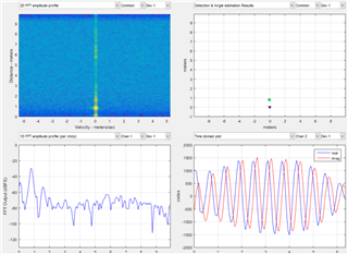

Can you help with solving the customer issue regarding phase noise? The customer browsed the forum but was unable to find a solution.
They are trying to obtain vital signs with raw data using the AWR1642BOOST + DCA1000EVM. They can detect chest correctly in the range fft. However, the phase obtained from fft complex from single chirp each successive frame has very high noise and it shows no signs of vital sign. hey think thata there is some kind of noise compensation at the steps of capturing data.
What they did was to first obtain the adc data bin file > process the bin file and obtain the range bin of target > obtain the complex data per frame to get phase using arc tangent. Also wanted to ask is if there is there is option to make the radar fmicw (i = interupted) in mmwavestudio so there are less reflections?
I have attached the Figures and Raw data below:
4338.Files.zip
In the above, The customer simple parameters for recording fast 10s data. Parameters >>> Frames = 250, chirp = 3, adc = 128 and just use rx = 1. The circle dot figures are of the complex points they obtain from each rangefft. So 250 frames and we chose the second chirp as they saw some reference work that it provides better results. Also they find the range bin for most cases max peak is 10-13. basically they use the bin in this range and replace it with 10 incase it some random number like 2 because of their chest target is 10-13.
The attached two figures of the complex plot shows just random data. also have the phase displacement signal. This is obtained by arc tangent demodulation on the complex values and taking the difference for each successive point. This plot shows that there is large noise and sudden outliers.
The first observation that came to my mind is that It may be a problem with the parsing of data so I pointed them to this thread however, it does not solve the issue.
Can you please help?

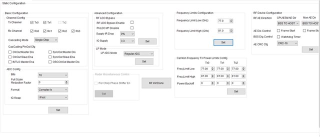

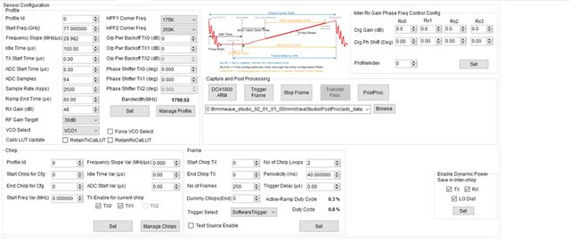

    Could the customer also provide snapshots of other mmwave studio tabs that were modified
    • Connection
    • Static Config
    • Data Config
    I recommend the customer creates a LUA script that will include the configuration. Similar to the following. This should save a lot of time
    https://e2e.ti.com/support/sensors-group/sensors/f/sensors-forum/1112328/dca1000evm-false-return-in-data-dca1000evm-awr1843boost/4122568?tisearch=e2e-sitesearch&keymatch=frameconfig#4122568
    Thank you
    Cesar
  • Hi Cesar,
    The customer is facing an issue posting a reply. He has provided the screenshots for all the tabs that were changed, which are attached below. He mentioned that he is inexperienced in generating the lua script file, so only the screenshots are provided.

    I checked their configuration file, and run through the rampTimingCalculator tab inside the mmwave Studio GUI.   I think they can use a little bit longer total ramp time and longer ADC start time.  Please follow the figure below with orange box.
    Zigang
  • Hi Team,
    Thank you for waiting. The customer tried your suggestions however the results are still the same.
    The results still have that same error discussed before and they are not sure why since they have gotten good results before.

    Please ask the customer to provide the heatmap plot in postProc generated in mmWave studio with static target to see whether range-Doppler heatmap looks normal.  I won't be able to help with non-static target results.
    Zigang
  • Hi Zigang,
    Thank you for your continuous support. Here is the heatmap images:
    The customer took the capture at target being less than 1m.
    I hope this helps. Let me know if you need more information.
    Marvin
  • HI, Marvin:
    Thank you!  What are these two figures?  Does the two figures above shows the first and second chirp of the capture?  ADC data does show big variation.
    Zigang
  • Hi Zigang,
    Apologies for this. The figures provided were from different captures, frames and chirps.
    Please see the new attached images below. These new figures are named as f = frame and c = chirp number (ie. f1c1 = frame 1 and chirp 1).
    The customer added frame1's chirp 1-3 so you can check if it's correct. Coming to the phase extraction, they only need a single chirp from each frame. So an example for the data would be f1c2, f2c2 and f3c2 (getting chirp 2 from every single frame), which is also provided to see if plots are ideal. Please let me know if more information is required.
    8015.attachments.zip
    Marvin

    From the figure, it shows the signal variation within f1 is very small (f1c1, f1c2, f1c3).  However, the variation between frames are very observable (f1c2, f2c2, f3c2).
    1) Can you confirm that the results are captured with static target?
    2) Can you send me the chirp configuration they are using for me to review?
    Zigang
